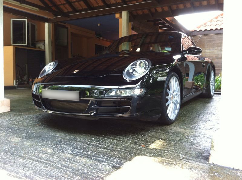

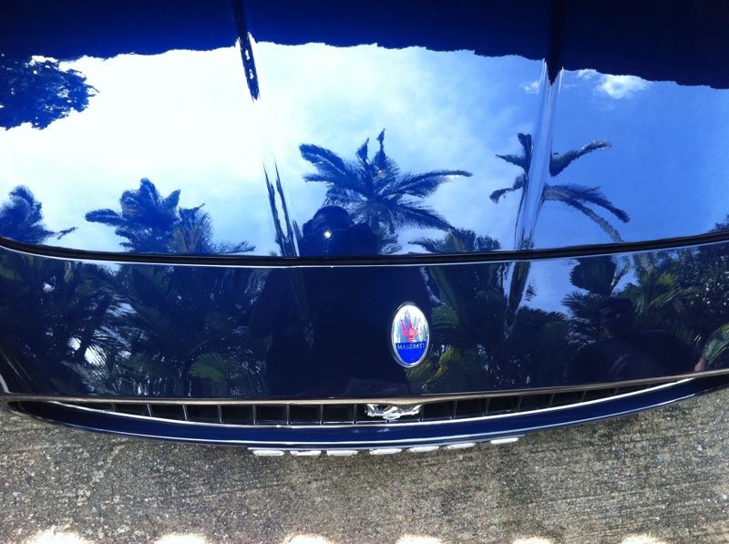

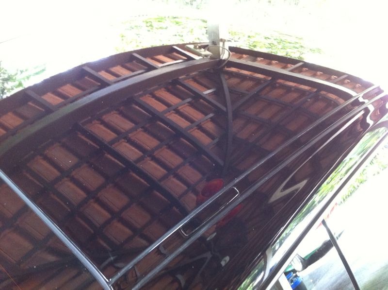

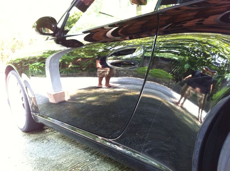

Yo Benny lai lai support you.
Here's my current and previous B&B car that used Duragloss / Optimum products.
Below are my routine steps to maintain the wet wet look.
External
1) Rinse(wet) the whole car with water
2) Wash car with Duragloss Car wash concentrated (#902)
3) Rinse off the shampoo
4) Clay bar with #902 as lubricant
5) Rinse the whole car again
6) Wipe dry
7) Use Duragloss Polish Cleaner (#101)
8) Use Duragloss Plastic Polish (#681) on my head lamp and tail lamp
9) Apply 2 layer of Enviroshield including headlamp and tail lamp
10) Rest for 30min allow Enviroshield to cure at the same time
11) Apply Duragloss Marine/RV Quick Detailer (#521) and wait 15min
12) Finish off with Duragloss Aquawax (#952)
13) Lastly apply Opti-Bond Tire Gel to my tires then stand 1 side admire the hard work [hur]
Internal
1) Wipe down the leather seats
2) Clean with Duragloss Leather Shampoo (#441)
3) Wipe down with Duragloss Leather Conditioner (#221)
All his products are great but the one I like most would be Duragloss Aquawax (#952).
It produce a high gloss finish with minimal effort on clean paint. (Very good for lazy
people, doesn't need much time to apply this) I always used this as the last step, its
a great topper over any wax or sealant to enhance the glossiness. No matter which
car you drive, Benny will recommend the right Duragloss / Optimum for you. Buy
it try it and you be amaze.
Edited by Intel

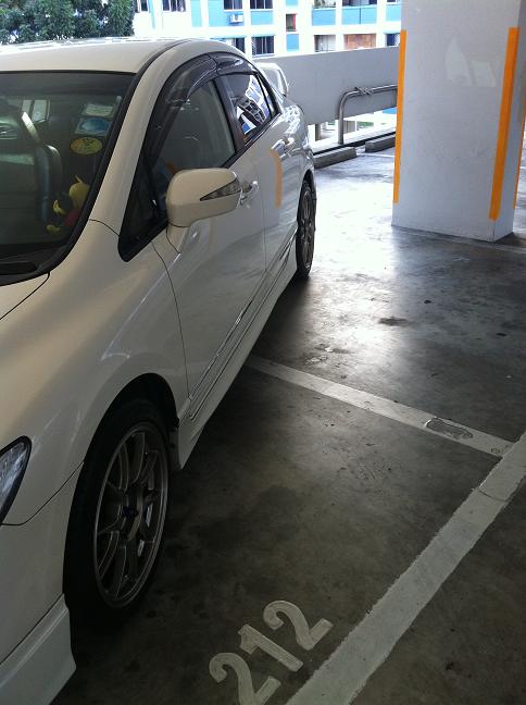

I bought a 05 Honda Civic and found that the paint does not have any protection against bird droppings and rain water. As my car is parked in the open most of the time, I knew I need to take good care of the paintwork. Thats when I came across Duragloss and decided to give it a try. Here are the photos of my car.
I wash my car on a weekly basis with the following steps and products.
1) Rinse the car with water to remove loose dirt particles.
2) Wash the car thoroughly with a microfiber sponge and shampoo.
3) Dry the car with the waffle weave drying cloth.
4) Apply a layer of Duragloss Paint Sealant. Let it haze for 15 min before wiping it off. (done once a month)
5) Apply a layer of Duragloss Aquawax for the wet look.
6) Clean the leather seats using Duragloss Leather Shampoo followed by Duragloss Leather Conditioner. (done bi-monthly)
For quick touch up, I use the Duragloss Marine/RV Quick Detailer.
After using the products, I find that the paint surface beads water nicely and water flows off easily. In the end, I find lesser water stains and bird droppings can be wiped off a lot easier.
