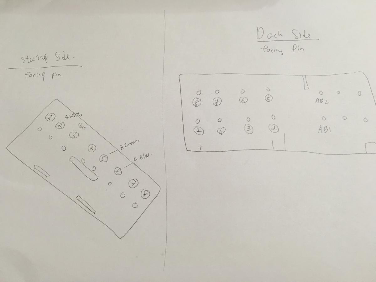

Mavwong 2nd Gear May 22, 2016 Share May 22, 2016 Those who experience same problem in luck now. Check out the pin out below. What you need to do is have the pin swap to another working pin. You got ur horn back. Most pin not use unless you have both audio control and cruise control install which most don't have. So you don't need to change the whole clock spring. Link to post Share on other sites More sharing options...
