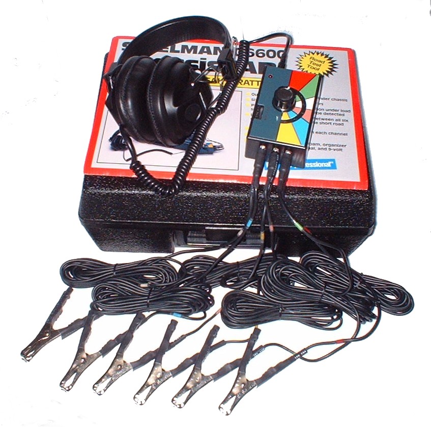

Pl confirm, rear brake is drum or disc type. Any service done on the assembly ?
Very sad, so call agent /distributor could not afford to own a electronic stethoscope to detect the source of the noise.
