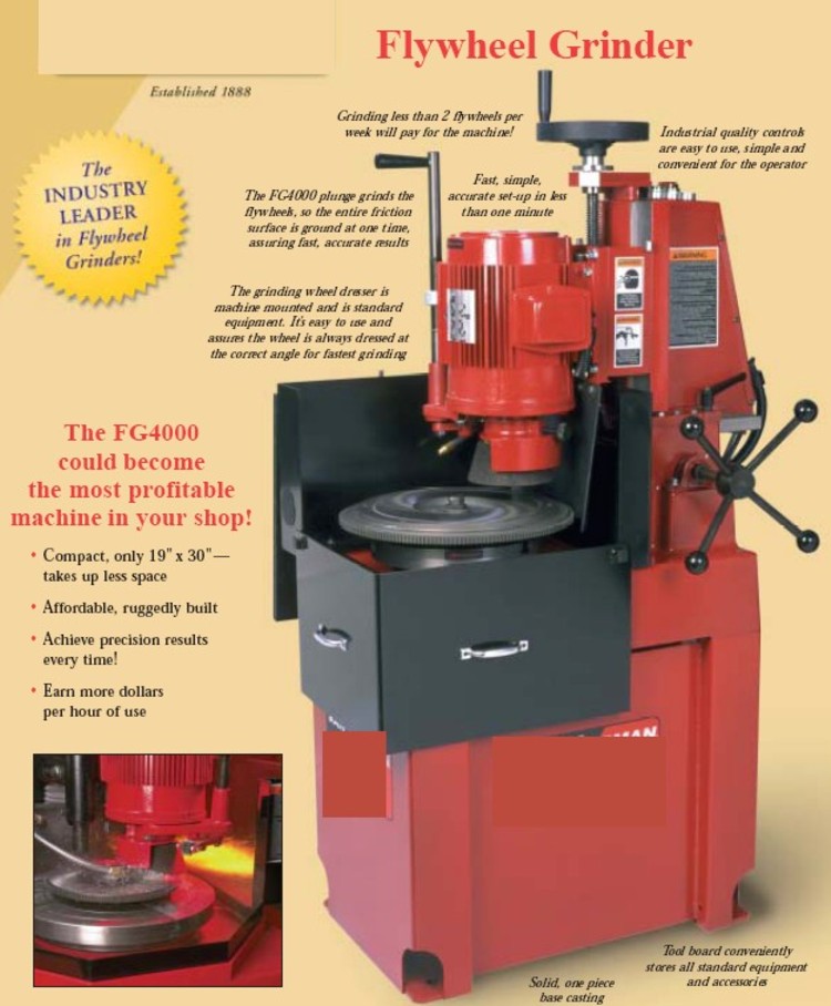

Yeobh 4th Gear June 11, 2012 Share June 11, 2012 (edited) Normally flywheels with uneven wear or burn /glazed marks are grind down only a few thousand of an inch. The whole idea is to get a very flat and straight surface to the flywheel axis so as to get the best clutch plate contact withno slip when transmitting power. Edited June 11, 2012 by Yeobh Link to post Share on other sites More sharing options...
Skyiet27 Clutched June 11, 2012 Share June 11, 2012 when ws down ur GB to replace clutch they can examine the condition of flywheel if theres a need to skim or replace better have it done due to down GB not cheap so in the case u same on labour as u no need to down again for future skim of fly but but last x when i driving manual n change gearing, clutch never once need to skim fly hahhahaa maybe u are rite seldom this practise locally as for me Link to post Share on other sites More sharing options...
Skyiet27 Clutched June 11, 2012 Share June 11, 2012 oh i guess is they dun have the proper mc as another bro show so mine last x was straight replaced n not skim hahhahaha Link to post Share on other sites More sharing options...
Yeobh 4th Gear June 11, 2012 Share June 11, 2012 The cheapest tool for small shop is a piece of diamond impregnated oil stone. Manually polishing can help to remove some wear marks and ridges. Link to post Share on other sites More sharing options...
