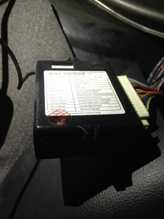

snowsushi Neutral Newbie March 6, 2014 Share March 6, 2014 Hi all! I did an emergency brake and this box fell out from the area above the pedals. Not sure if I broke something or it just came loose. No idea what it's for and where it should be... This is a Toyota Vios (bought 2007). Nothing else seems wrong other than this dangling box. There's this black rubber tube coming out from the box too. Do I need to send it for repair? PLEASE HELP :( Link to post Share on other sites More sharing options...
TVT Supercharged March 6, 2014 Share March 6, 2014 Hi all! I did an emergency brake and this box fell out from the area above the pedals. Not sure if I broke something or it just came loose. No idea what it's for and where it should be... This is a Toyota Vios (bought 2007). Do I need to send it for repair? PLEASE HELP :( First of all, are the brakes still working fine? There's some wordings on the sticker paste on the box. Take a look and see what it says.... Link to post Share on other sites More sharing options...
Kklim Supercharged March 6, 2014 Share March 6, 2014 Car alarm module? They usually stick that near the fuse box. Link to post Share on other sites More sharing options...
snowsushi Neutral Newbie March 6, 2014 Share March 6, 2014 First of all, are the brakes still working fine? There's some wordings on the sticker paste on the box. Take a look and see what it says.... Yes they're working fine! Everything seems to work fine (clutch, accelerator, gear box...). The sticker just says which wire is for what, e.g. grey wire for hazard light, blue/white wire for handbrake switch...nothing else :/ Link to post Share on other sites More sharing options...
Volvobrick Supersonic March 6, 2014 Share March 6, 2014 Car alarm module? They usually stick that near the fuse box. Yeah, looks like car alarm and the "tube" looks like the antenna wire. A rubber tube will not be crooked like that unless there is a metal wire inside making it an antenna. Just shove it back up. Link to post Share on other sites More sharing options...
TVT Supercharged March 6, 2014 Share March 6, 2014 Yes they're working fine! Everything seems to work fine (clutch, accelerator, gear box...). The sticker just says which wire is for what, e.g. grey wire for hazard light, blue/white wire for handbrake switch...nothing else :/ Could it be the fuse box ? Anyway, test all the lights, horn, power windows etc....if all working fine, then just put it back up (secure it with some tape or cable tie if necessary) and carry on driving lah.... Link to post Share on other sites More sharing options...
snowsushi Neutral Newbie March 6, 2014 Share March 6, 2014 Could it be the fuse box ? Anyway, test all the lights, horn, power windows etc....if all working fine, then just put it back up (secure it with some tape or cable tie if necessary) and carry on driving lah.... I tried Googling previously but to no avail...the closest I could find was "main harness" but I also don't know what that is .____. So I'm still not sure of what the box is :/ but I'll check out those other parts too! Thanks lots :) Link to post Share on other sites More sharing options...
Otacon Clutched March 7, 2014 Share March 7, 2014 I tried Googling previously but to no avail...the closest I could find was "main harness" but I also don't know what that is .____. So I'm still not sure of what the box is :/ but I'll check out those other parts too! Thanks lots :) could b fuse box, why dun drive to workshop n check? Link to post Share on other sites More sharing options...
Heartbreakid 6th Gear March 7, 2014 Share March 7, 2014 Hi all! I did an emergency brake and this box fell out from the area above the pedals. Not sure if I broke something or it just came loose. No idea what it's for and where it should be... This is a Toyota Vios (bought 2007). photo 1.JPG Nothing else seems wrong other than this dangling box. photo 2.JPG There's this black rubber tube coming out from the box too. photo 3.JPG photo 4.JPG Do I need to send it for repair? PLEASE HELP :( This the aftermarket car alarm module. Just get it secured back by cable tying or double sided tapes. Nothing to worry about. ↡ Advertisement Link to post Share on other sites More sharing options...
