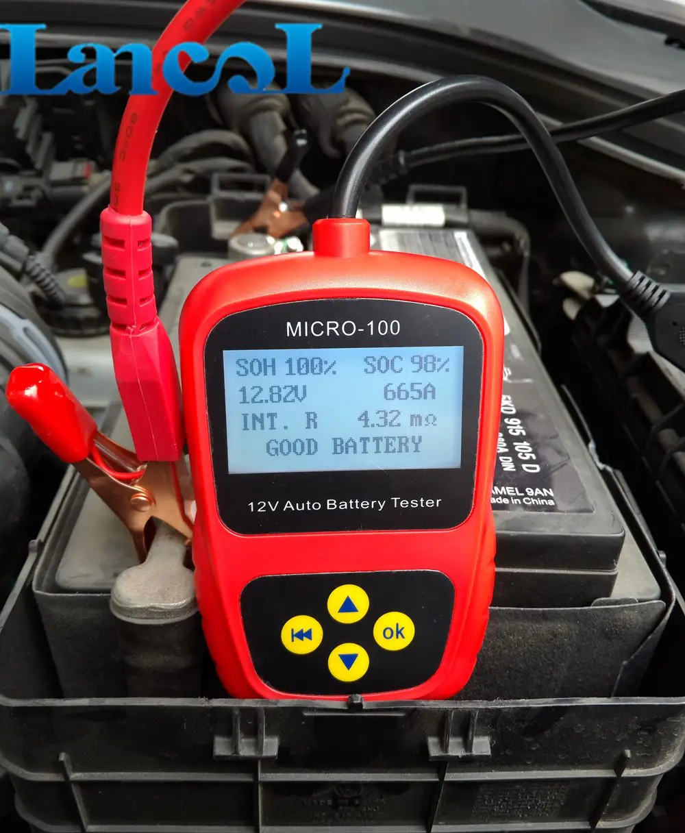

Watwheels Supersonic October 13, 2017 Share October 13, 2017 How many times ppl got to mention it's the CCA rating that matters? https://www.google.com.sg/search?q=ideal+cold+crank+amp&ie=utf-8&oe=utf-8&client=firefox-b&gfe_rd=cr&dcr=0&ei=hQ_gWZf4OK6IX5avkagL CCA is a rating used in the battery industry to define a battery's ability to start an engine in cold temperatures. The rating refers to the number of amps a 12-volt battery can deliver at 0°F for 30 seconds while maintaining a voltage of at least 7.2 volts. You gotta have a device like this...called th battery analyzer. It's not a cheap device. It costs around $200+ to $300. You can get this from online shops but no point coz when the battery fails this thing cannot save it. It can only tell you good or bad. It doesn't advise you when to change your car battery. Link to post Share on other sites More sharing options...

Kklee 6th Gear October 13, 2017 Share October 13, 2017 (edited) How many times ppl got to mention it's the CCA rating that matters? https://www.google.com.sg/search?q=ideal+cold+crank+amp&ie=utf-8&oe=utf-8&client=firefox-b&gfe_rd=cr&dcr=0&ei=hQ_gWZf4OK6IX5avkagL You gotta have a device like this...called th battery analyzer. It's not a cheap device. It costs around $200+ to $300. You can get this from online shops but no point coz when the battery fails this thing cannot save it. It can only tell you good or bad. It doesn't advise you when to change your car battery. Aliexpress below SGD100. If SOH is State of Health, the % may give an indication of the health of the battery. Alternatively, the A and internal resistance may also give an indication but reference needs to be taken when the battery is new or known to be good. E.g. if SOH is at 50%, you have to decide if want to change. Likely I may wait until 25%. Yesterday, my car have weak cranking. Immediately drove to battery shop and change it. Amaron battery, lasted me for two years. the battery connector broke into half and full of greenish powder on it. Lucky no short circuit. Changed the same brand 80ah. I think called hi life pro. S$160 for the battery. Just curious, the sidewalls of the old battery got become bloated? Edited October 13, 2017 by Kklee ↡ Advertisement Link to post Share on other sites More sharing options...
