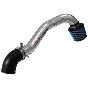

1) Short Ram air intake.
This type of air intake provides the shortest possible route for the air to reach the throttle body or turbo inlet.
hps_performance_short_ram_air_intakes_bl
What ppl say: It sucks engine heat.
My opinion: Yes. Ppl are correct. There's a....but.
Application: More suitable for turbocharged engine. Why? Regardless whether cool air or hot air enters the turbo it will be heated up....this is where the air intercooler comes into play and cools the hot air. So whether you are using a cold air intake or short ram intake it doesn't matter much.
Pros: With tuning and used with a turbocharged engine it performs well and sounds the part coz you get to hear the waste gate work. The stock airbox is a muffler that silence every noise.
Cons: Noise caused by the air moving thru the pipe works. Not suitable for NA engines as it really does suck in more engine heat.

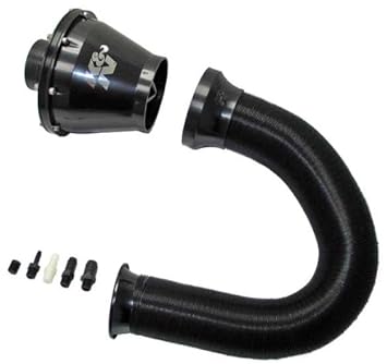

2) Cold Air Intake or CAI
The pipe works are routed in such a way that it draws ambient air or outside the engine bay's air rather dan sucking hot air from inside the engine bay. Ppl will try to install the open pod nearer to the bottom of the car and/or as near to the front of the front bumper as possible and away from the heat. Usually has longer pipe works.
You will see ppl cut a hole on their front  bumper to install this type of air duct to draw ambient air.
What ppl say: It sucks engine heat. (To them these two types are no different, looks the same)
My opinion: Yeah. It does draw hot air...in Singapore's climate. Looking at the metal parts and installed inside the engine bay, cool air becomes hot air and hot air becomes hotter air.
Pros: More suited for NA engines...in cooler climate. But it also requires tuning to be effective.
Cons: Money spent but insignificant results (tuning a NA small engine does not yield much results too). Plus the air sucking noises it makes.
