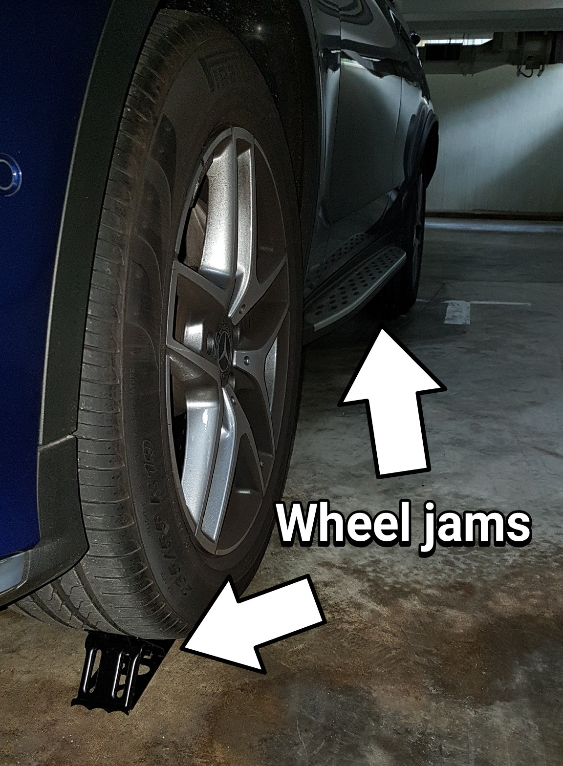

Getting ready for the installation.
Gather all tools and parts required so that you do not have to stop halfway and revert to original when you realise you are short of something:
1) the spacer system you decided on.
2) car jacking system, in ny case, my car do not come with car jack as it has RFT fitted from factory, so I had to source for my own car jack that can handle the higher ground clearance of an SUV. Also remember that some car brands have special jacking points requiring adapters.
Often missed out component of a jacking system are the wheel jams. These prevent the car from accidentally rolling off it's jacked position.
3) Bolts removal system. Most cars comes with 17mm hex bolt/nut. So prepare the correct sized hex socket tool. Having a breaker bar is a good to have but not essential, just makes loosening the bolts/nuts much more effortless. Also get a torque wrench that is specced to at least 100 to 200nm. Check you car's manual for the recommended torque specs.
4) Copper grease which is an anti-seize. It essentially prevents your spacer from seizing/stuck onto your wheel hub. The wheels can also get stuck to the wheel hub but due to the wheel size, it is easy to just kick the tires/use wooden mallet to knock it loose (seen some tire shop does that) using moments.
5) grip gloves are good to reduce the hand fatigue from increased grip power. Keeping the hands clean is secondary.
#notmypresident

Jacking and Removal of of the wheels.
1. Park your car on a level surface with solid floor (not gravel/not soil)
2. Insert the wheel jams into the front of the 2 wheels on opposite side of where you intend to jack up.
3. Using your 17mm Hex Socket and breaker bar (use extension bar if required), loosen all the bolts but keep all of them partially threaded to prevent the wheel from falling off while you are jacking up the car.
4. Place any jack point adaptor your car may require and jack the car up to a point where the tire just lifted off the ground, approx 5mm clearance is ideal. The more is NOT merrier here. Too high, you will waste more energy and potentially hurt your back trying to remove and reinstall the wheel.
*note, if you are using a hydraulic floor jack like mine, make sure you have a safety lock in case the hydraulic valve suddenly give way while the car is jacked. Alternative use a jack stand as a secondary safety backup.
5. Now use your Hex Socket and manually unthread all the bolts from the wheel/hub. Be careful now because your wheel will just be hanging onto the hub flange.
6. Position yourself as close to the wheel on your knees, back straighten, with 2 hands hold the rim spoke in the 3 and 9 o'clock position. Pull it towards yourself in a smooth clean jerk and allow it to sit in the floor.
7. Wriggle the wheel towards you till the whole wheel clears the wheel hub/brake caliper/rotor.  And proceed to roll the wheel aside to a safe place and put it flat on it's inner side (not to scratch the outer part of the rim)
Edited by Vratenza, 03 September 2017 - 11:58 AM.
