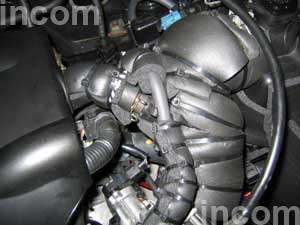

Incom 1st Gear November 1, 2005 Share November 1, 2005 No more worrying the petrol needle drop very fast when driving during hot weather. Goes very well with my LRF. Cheers Link to post Share on other sites More sharing options...
Incom 1st Gear November 1, 2005 Share November 1, 2005 (edited) Happy DIYing, and remember to post some pictures for use to see. The above pictures are for Stage 01 of my Heat Shield Project. Pictures for Stage 02 coming up later. Cheers Edited November 1, 2005 by Incom Link to post Share on other sites More sharing options...

Incom 1st Gear November 1, 2005 Share November 1, 2005 Ya, u need lots of time and water. I took abt 4 hours to complete the wrapping the air box. Additional 2 hours to wrap up the tube from air intake box to throttle body. Cheers. Link to post Share on other sites More sharing options...

Incom 1st Gear November 1, 2005 Share November 1, 2005 (edited) I am using 3M double sided tape, those dark grey material with red label one. Sticks very well for plastic materials. Stage 02 pictures below. Cheers Edited November 1, 2005 by Incom Link to post Share on other sites More sharing options...
