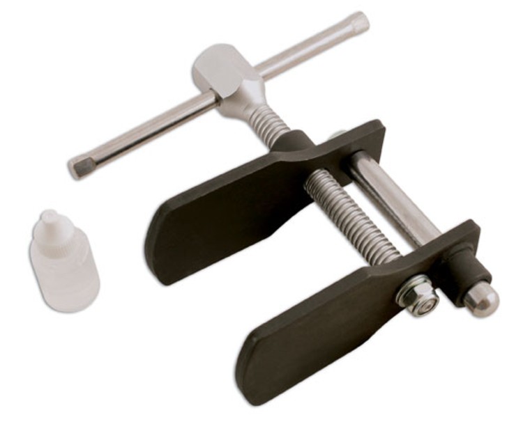

Yr mech may have not push back the piston(s) far enough. The pad is force into position resulting is a very tight fit - it very bad as the fiction will cause brake seizure due to high heat generated. Suggest yr mech remove the pad, move the piston back as much as possible and rework/clean up the caliper.
PS spreading the piston with a screw driver is not the right way to do the job - what they need is a disc piston spreader
