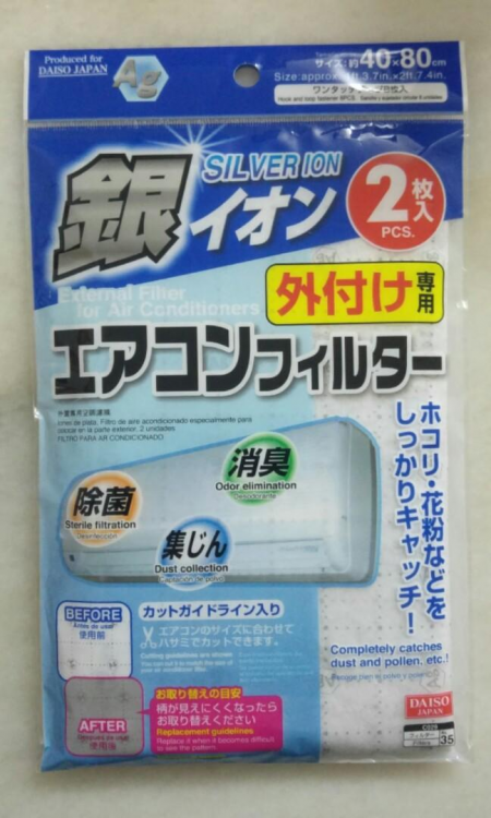

Mkl22 Supersonic August 13, 2021 Share August 13, 2021 On 8/11/2021 at 2:28 PM, Kb27 said: Yeap, Sanyo no longer around. It was one of the best brand yesteryears. Before I had a Sys 3 Sharp in my old place. Keep having problem occasionally. Then the Sharp technician came and diagnose, it was copper piping kinked during installation. So have to look out for this when you're installing new aircon. Later I had a fujitsu Sys 1. It was working nicely until it starts to leak water and was no cold air. I replaced it with Mit Starmex, but on hindsight, the fujistu just needed a FCU cleaning. That's when I found out after learning to DIY clean the Starmex. And my old Sanyo is still working. If I were to buy a new one tomorrow, I'll probably just consider Jap brands. It's a very stable technology, now with inverters. And remember, the fcu needs regular cleaning, the cooling coil especially, not just the filters and blowers. There's no need to look at fancy "technology". There are all the same variations of a theme. The only important thing is the inverters. just cleaned my starmex yesterday via pressure wash. after approx 5mths if usage.not that dirty as i use the daiso filter so that less dust is stuck on the cooling fins. Won't need any aircon tech to come unless parts break. as long as aircons are not dismantled for cleaning. then will last a long time. 3 Link to post Share on other sites More sharing options...
Henryngseowkok 2nd Gear August 13, 2021 Share August 13, 2021 23 minutes ago, Mkl22 said: just cleaned my starmex yesterday via pressure wash. after approx 5mths if usage.not that dirty as i use the daiso filter so that less dust is stuck on the cooling fins. Won't need any aircon tech to come unless parts break. as long as aircons are not dismantled for cleaning. then will last a long time. Hi, may I know which type of air con filter you bought from Daiso? Mine is starmex system 3. Inside the filter it is a long small silver one and is very dirty n dunno where to buy. Thanks Link to post Share on other sites More sharing options...

Mkl22 Supersonic August 13, 2021 Share August 13, 2021 15 minutes ago, Henryngseowkok said: Hi, may I know which type of air con filter you bought from Daiso? Mine is starmex system 3. Inside the filter it is a long small silver one and is very dirty n dunno where to buy. Thanks 1 Link to post Share on other sites More sharing options...

Henryngseowkok 2nd Gear August 13, 2021 Share August 13, 2021 1 minute ago, Mkl22 said: Thanks bro! Will go to Chinatown point Daiso to look for this filter. 43 minutes ago, Mkl22 said: just cleaned my starmex yesterday via pressure wash. after approx 5mths if usage.not that dirty as i use the daiso filter so that less dust is stuck on the cooling fins. Won't need any aircon tech to come unless parts break. as long as aircons are not dismantled for cleaning. then will last a long time. Hi, may I know which type of air con filter you bought from Daiso? Mine is starmex system 3. Inside the filter it is a long small silver one and is very dirty n dunno where to buy. Thanks Link to post Share on other sites More sharing options...
