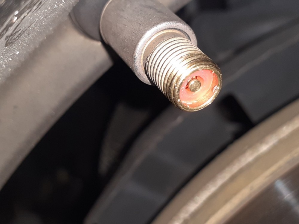

Philipkee Twincharged September 24, 2020 Share September 24, 2020 Anyone knows what it's this? I went to fix my tire recently cos there seemed to be a slow leak. The man said maybe there is a leak in the valve stem but it's not obvious. So I was like whatever. Tire pressure normal and all was good. Today I went to pump air into my tire and I realised I couldn't pump air inside. Then I noticed this. Well, there is no leak but the pressure is slightly lesser than what I like so I wanted to top up but couldn't. Anyone knows what is this and can it be removed? It seems like putty and not washer so..... It's the red colour thing. ↡ Advertisement 1 Link to post Share on other sites More sharing options...

Philipkee Twincharged September 24, 2020 Author Share September 24, 2020 32 minutes ago, Sdf4786k said: First time seeing as well. So when you were driving , the TPMS register a leak.? Was all 4 tires stem the same or was this from the tire shop. Only one tire. The mechanic say nothing wrong. So I did not care or notice since after he did what he did the tire pressure remained stable. Only today did I realise something is inside when I wanted to pump some air inside and the pump just couldn't pump anything inside. Then I noticed this Link to post Share on other sites More sharing options...
Philipkee Twincharged September 24, 2020 Author Share September 24, 2020 2 minutes ago, Mkl22 said: yeah, dont even need to remove the tire. even if they need to replace the whole valve, they will just crack open the tire bead and push it down to replace the valve. very fast too. Then why put this red thing? Cheaper? Faster? Link to post Share on other sites More sharing options...
kobayashiGT Internal Moderator September 24, 2020 Share September 24, 2020 42 minutes ago, Philipkee said: Anyone knows what it's this? I went to fix my tire recently cos there seemed to be a slow leak. The man said maybe there is a leak in the valve stem but it's not obvious. So I was like whatever. Tire pressure normal and all was good. Today I went to pump air into my tire and I realised I couldn't pump air inside. Then I noticed this. Well, there is no leak but the pressure is slightly lesser than what I like so I wanted to top up but couldn't. Anyone knows what is this and can it be removed? It seems like putty and not washer so..... It's the red colour thing. Your picture abit blur leh. hahah. Anyway, you can drive down to any tyre shop and ask them to help you change the whole valve. not expensive lah. Better than the air keep leaking. 1 Link to post Share on other sites More sharing options...

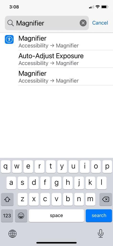

Watwheels Supersonic September 24, 2020 Share September 24, 2020 15 minutes ago, Philipkee said: Omg. I sent this picture to my mechanic he say the same thing (in a nicer way......) For Android For iOS, put this function in the triple click. Learn Learn Learn ! 1 5 Link to post Share on other sites More sharing options...

Philipkee Twincharged September 24, 2020 Author Share September 24, 2020 Anyway I removed it liao after speaking to my mechanic on WhatsApp. I just wonder why the other mechanic put it there if no leak. At least that what he said though I felt otherwise. Anyway due for tire rotation soon so maybe I will change the valve stem then. Unless coe crash in oct. Link to post Share on other sites More sharing options...
Watwheels Supersonic September 24, 2020 Share September 24, 2020 (edited) That's better, boy. The red rubber washer is from your valve cap. It somehow got stuck there. Use something sharp and dig it out, put back in the valve cap. Make sure it sits properly otherwise you will experience some leak. See what a good picture can help. Dont be lazy and sloppy. Note: Do not over tighten your valve cap. I think that's what you did. That's why got stuck there. Edited September 24, 2020 by Watwheels 3 Link to post Share on other sites More sharing options...
Colin03 4th Gear September 24, 2020 Share September 24, 2020 The red washer suppose to be on the cap end. Over tightening cause it to stuck on the valve. Link to post Share on other sites More sharing options...
Philipkee Twincharged September 24, 2020 Author Share September 24, 2020 3 hours ago, Colin03 said: The red washer suppose to be on the cap end. Over tightening cause it to stuck on the valve. Problem is I am not supposed to have that washer, I think. Cos I am using external TPMS as the cap. Wonder where it came from..... Link to post Share on other sites More sharing options...
Volvobrick Supersonic September 24, 2020 Share September 24, 2020 4 minutes ago, Philipkee said: Problem is I am not supposed to have that washer, I think. Cos I am using external TPMS as the cap. Wonder where it came from..... Might be from the TPMS as it needs a good seal to prevent air escaping. I think once you screw it on, it will actually depresses the valve stem to pressurise the sensor. ↡ Advertisement 1 1 Link to post Share on other sites More sharing options...
