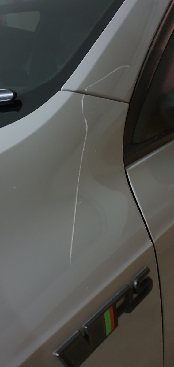

13luetooth 1st Gear February 17, 2021 Share February 17, 2021 Hi everyone, Can I ignore this scratches or I should just patch it up to prevent it from getting deep and eventually rust the metal? If its just at the clear coat level, I guess I can ignore it right? Generally how much does fixing scratches cost? ↡ Advertisement 1 Link to post Share on other sites More sharing options...
Mooose 6th Gear February 17, 2021 Share February 17, 2021 51 minutes ago, 13luetooth said: Hi everyone, Can I ignore this scratches or I should just patch it up to prevent it from getting deep and eventually rust the metal? If its just at the clear coat level, I guess I can ignore it right? Generally how much does fixing scratches cost? i must admit i have old flower eyes, but it looks like a good polish (like autoglym super resin) may reduce how visible it is at a glance, but will not totally eliminate the line .. Link to post Share on other sites More sharing options...
bezza2460 Clutched February 17, 2021 Share February 17, 2021 I think polishing will help. 2 Link to post Share on other sites More sharing options...
Stratovarius Turbocharged February 17, 2021 Share February 17, 2021 Looks like still within the paint layer. Take a polishing compound and rub. If the line colour is the same as paint, the scratch did not go to the primer. Link to post Share on other sites More sharing options...
Ceecookie 5th Gear February 17, 2021 Share February 17, 2021 Based on personal experience, u should be able to reduce it by 60-70% after diy polishing. If the scratch is too deep, even professional buffering or polishing by WS cannot remove 100%. Can only repaint. Suggest u diy first, then do professional polish or respray only when car have more scratches down the road. 1 Link to post Share on other sites More sharing options...
Colin03 4th Gear February 17, 2021 Share February 17, 2021 Can a resin wax for RED colour if u can find. Should be able to clear 70 to 80% from current appearance. Link to post Share on other sites More sharing options...
kobayashiGT Internal Moderator February 17, 2021 Share February 17, 2021 2 hours ago, 13luetooth said: Hi everyone, Can I ignore this scratches or I should just patch it up to prevent it from getting deep and eventually rust the metal? If its just at the clear coat level, I guess I can ignore it right? Generally how much does fixing scratches cost? This one polish can remove le. try this! https://shopee.sg/Soft99-Rubbing-Compound-Metallic-i.60477235.1025579094 Link to post Share on other sites More sharing options...
Ct3833 Supersonic February 17, 2021 Share February 17, 2021 the scratch is in one's heart. leave it alone and the scratch will disappear after a while. 3 4 Link to post Share on other sites More sharing options...
13luetooth 1st Gear February 17, 2021 Author Share February 17, 2021 52 minutes ago, Ct3833 said: the scratch is in one's heart. leave it alone and the scratch will disappear after a while. I like this. my car is only 7th weeks old la haha. i'm actually ok now. Initially heart pain for like 2 hours then see through it already. Now I just hope that I don't ignore this until it becomes a problem to the chassis itself. 2 Link to post Share on other sites More sharing options...
13luetooth 1st Gear February 17, 2021 Author Share February 17, 2021 57 minutes ago, kobayashiGT said: This one polish can remove le. try this! https://shopee.sg/Soft99-Rubbing-Compound-Metallic-i.60477235.1025579094 I'm noob in this. my frend was telling me that I need to claybar before doing any polishing. Is it necessary? Or I can just wash it then do the polishing right away? 1 Link to post Share on other sites More sharing options...
kobayashiGT Internal Moderator February 17, 2021 Share February 17, 2021 8 minutes ago, 13luetooth said: I'm noob in this. my frend was telling me that I need to claybar before doing any polishing. Is it necessary? Or I can just wash it then do the polishing right away? If you only wanna polish that portion, no need to clay lah. just wash the car and then you start polish. I will only recommend you hand polish. because you dunno machine how much grit and rpm to polish off. Hand is the safest. Just go circular with the polish on the sponge. let it cure for a few minutes, then use a microfibre cloth and buff off. If still have the line, you can try a few more times. then afterwhich, if cannot. then you have to assess you wanna do spot painting or send it to a professional polisher. 1 Link to post Share on other sites More sharing options...
kobayashiGT Internal Moderator February 17, 2021 Share February 17, 2021 16 minutes ago, 13luetooth said: I like this. my car is only 7th weeks old la haha. i'm actually ok now. Initially heart pain for like 2 hours then see through it already. Now I just hope that I don't ignore this until it becomes a problem to the chassis itself. Just be prepared when you are driving. Just will have dinks and scratch one. 🙂 Last time when I drive my father car, when I scratch his car, i will paste a sticker over. 🙂 you can try that method too. hahaha. 2 Link to post Share on other sites More sharing options...
13luetooth 1st Gear February 17, 2021 Author Share February 17, 2021 5 minutes ago, kobayashiGT said: If you only wanna polish that portion, no need to clay lah. just wash the car and then you start polish. I will only recommend you hand polish. because you dunno machine how much grit and rpm to polish off. Hand is the safest. Just go circular with the polish on the sponge. let it cure for a few minutes, then use a microfibre cloth and buff off. If still have the line, you can try a few more times. then afterwhich, if cannot. then you have to assess you wanna do spot painting or send it to a professional polisher. if cannot then I just ignore liao hahaha. I doubt it affect the metal itself. 1 Link to post Share on other sites More sharing options...
kobayashiGT Internal Moderator February 17, 2021 Share February 17, 2021 1 minute ago, 13luetooth said: if cannot then I just ignore liao hahaha. I doubt it affect the metal itself. yah. don't think will affect. You can still sticker it away. hahaha. 1 Link to post Share on other sites More sharing options...
