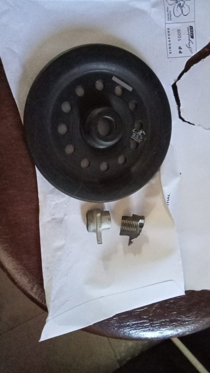

vincenttan67 June 6 Share June 6 (edited) DEC 2021 Jan i went to carousel and saw this shop doing car aircon compressor @$98, name: S_ _ r_ _ _r. so i went down to his workshop at 160 sin ming #08 floor to change my compressor, he said condenser,very dirty and need to change new one and will do a vacuum, the price of the compressor is $448 for a new one and the condenser closed to $700, during the installation,i request the mechanic to top up oil into the compressor, but he refused and said inside already come with oil, so not choice and i have to let it be. vacuum using external motor, after collecting my car, the aircon is average only, not satisfactory at all, so i ask them, they said my cooling coil cover up with dirt some where in oct 2022, i did once car vacuum and oil top up in johore i only use my car twice a week, but today my compressor jammed and puller and screw broken up, , i went back and ask the boss how come compressor break down after using 2 1/2 year only , boss replied what to do? i can't give 10 year warranty ! and he said his mechanic left and he actually do not know how to do car vacuum, so that is why my car compressor jammed up with dirt. I went to other aircon specilize mechanic today at kakit bukit and the mechanic top up 10ML of green oil into the compressor. he told me although got oil in the compressor, but still need to top up . play safe. also ask me want to get good one or OEM no brand type, i told him good one, $580, complete with machine vacuum, 2 years aircon problem solve, very cold from the switch 1,2,3,4 Edited June 6 by vincenttan67 ↡ Advertisement 1 1 Link to post Share on other sites More sharing options...

kobayashiGT Internal Moderator June 7 Share June 7 On 6/6/2024 at 8:31 PM, vincenttan67 said: DEC 2021 Jan i went to carousel and saw this shop doing car aircon compressor @$98, name: S_ _ r_ _ _r. so i went down to his workshop at 160 sin ming #08 floor to change my compressor, he said condenser,very dirty and need to change new one and will do a vacuum, the price of the compressor is $448 for a new one and the condenser closed to $700, during the installation,i request the mechanic to top up oil into the compressor, but he refused and said inside already come with oil, so not choice and i have to let it be. vacuum using external motor, after collecting my car, the aircon is average only, not satisfactory at all, so i ask them, they said my cooling coil cover up with dirt some where in oct 2022, i did once car vacuum and oil top up in johore i only use my car twice a week, but today my compressor jammed and puller and screw broken up, , i went back and ask the boss how come compressor break down after using 2 1/2 year only , boss replied what to do? i can't give 10 year warranty ! and he said his mechanic left and he actually do not know how to do car vacuum, so that is why my car compressor jammed up with dirt. I went to other aircon specilize mechanic today at kakit bukit and the mechanic top up 10ML of green oil into the compressor. he told me although got oil in the compressor, but still need to top up . play safe. also ask me want to get good one or OEM no brand type, i told him good one, $580, complete with machine vacuum, 2 years aircon problem solve, very cold from the switch 1,2,3,4 Erm. u have used for 2 years liao, cannot go back to the workshop for any guarantee lah. Abit not fair. I think this kinda thing cannot be prevented one. If really suay suay, then replace the pulley and screw lor. The question now is is your air con cold now? Very crucial for SG driving one leh. 2 Link to post Share on other sites More sharing options...
Beregond Supersonic June 7 Share June 7 On 6/7/2024 at 11:24 AM, kobayashiGT said: Erm. u have used for 2 years liao, cannot go back to the workshop for any guarantee lah. Abit not fair. I think this kinda thing cannot be prevented one. If really suay suay, then replace the pulley and screw lor. The question now is is your air con cold now? Very crucial for SG driving one leh. For the record. Most of the new compressor are not given warranty. ( from supplier to WS). if WS give out Warrently like 1year. And it break down in 9mth. Most cases they cannot claim from supplier. If they give u 1 year warranty. The mark up% will be at least 100% +++++. To cover their risk. 2 Link to post Share on other sites More sharing options...

Boxster 2nd Gear June 19 Share June 19 (edited) @vincenttan67 So in the end did you managed to replace only the pulley? If I am not wrong this compressor is a variable displacment compressor. So there is a pulley that slips and break when the compressor has a mechanical jam and the rest of the belt system will continue to operate. If the compressor has jamed I doubt replacing pulley will solve the problem as it might be damaged. Normally will require replacement of the compressor and flushing the AC system of debris. Edited June 19 by Boxster Link to post Share on other sites More sharing options...
vincenttan67 June 19 Author Share June 19 @Boxster nowsday the easy way is to replace the whole aircon compressor, i also did not want to go and find , so just change to a new one this and a new aircon mechanic, dare not go sin ming anymore. now very cold . Also just share share abit As for car alternator, i still manage to find mechanic whom can take out and repair the inside ,the carbon, cost very little money, oher mechanic whom do not want to do will ask customer to change the whole new alternator. cost very high ↡ Advertisement 1 Link to post Share on other sites More sharing options...
