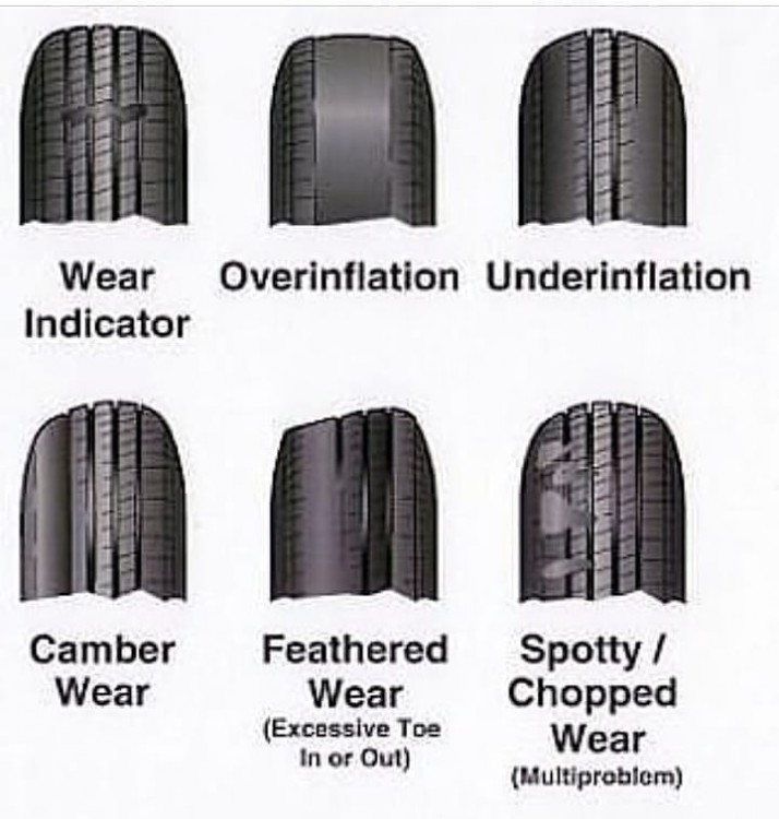

Mazdaowner Moderator November 28, 2011 Share November 28, 2011 my ride is coming to 2 yrs so wondering if I should change battery or tyres? my prev ride kenna battery die 2 times but that was after 2 yrs close to 3 yrs Here is my take for tires, every tire at the sie wall there is a triangle mark, this mark indicates when to change your tires, when the face of the tire is worn till it almost reaches the apex of the triangle, it is time to have the tire replaced. See attached picture. 2 Link to post Share on other sites More sharing options...

SimonTan 2nd Gear November 28, 2011 Share November 28, 2011 U joking right? The triangle shows where the wear down marks are on the face of the thread. If reall as you say.....then all tyres will be botak and yet will not touch the tip of the triangle. Here is my take for tires, every tire at the sie wall there is a triangle mark, this mark indicates when to change your tires, when the face of the tire is worn till it almost reaches the apex of the triangle, it is time to have the tire replaced. See attached picture. ↡ Advertisement Link to post Share on other sites More sharing options...
