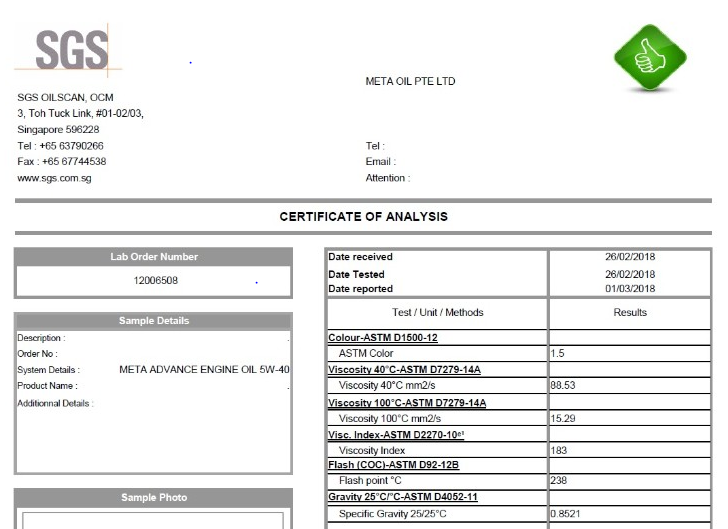

Anybody else tried Meta Oil 5W40?

Viscosity at 100 degrees-Celsius,   the difference between Shell Helix Ultra 5w40 and 5w30 is 0.9.
Shell Helix Ultra 5w40 is at the lower range of the w40 where Shell Helix Ultra 5w30 is on the higher range of the w30.
The difference between Shell Helix Ultra 5w40 and Pennzoil Ultra Platinum 5w30 is 2.8.
For comparison,  difference Meta & Shell 5w40 is 2.9 or Meta & Shell 5w30 is 3.19.
IMHO,  if between Shell 5w40 and Shell 5w30 is not significant, try an even lower viscosity EO like Pennzoil 5w30 or Motul 5w30.
If it is to resolve a FC issue, then perhaps a dose of fuel system cleaner like Caltex Techron Concentrate or Redline SI-1.
If still the same, look at other components like throttle body.
Thks for yr detail reply!
Do u mind elaborating on the "difference in value" e.g. difference between Shell Helix Ultra 5w40 and 5w30 is 0.9., difference between Shell Helix Ultra 5w40 and Pennzoil Ultra Platinum 5w30 is 2.8.
How do I make sense of the no.s?

Google for kinematic viscosity [;)]  [;)]  [;)]
