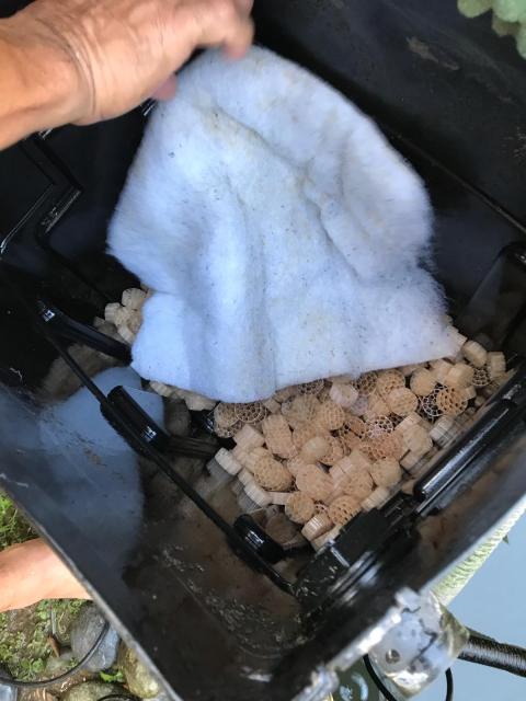

therock Supersonic October 2, 2018 Author Share October 2, 2018 It’s in the first post? I think I moved something and the system stopped sucking? The pump now pushes water instead of sucking into the black box.. Previously two outlets from the black box pour water into the pond There’s some kind of suction in the middle of the pond. It’s too murky to see now .. Link to post Share on other sites More sharing options...
Adrianli Hypersonic October 2, 2018 Share October 2, 2018 It’s in the first post? I think I moved something and the system stopped sucking? The pump now pushes water instead of sucking into the black box.. Previously two outlets from the black box pour water into the pond There’s some kind of suction in the middle of the pond. It’s too murky to see now .. That means, your suction line has air lock. Thus unable to suck. You will need to re-prime the line with water for the pump to work. Link to post Share on other sites More sharing options...
Si4dr 5th Gear October 2, 2018 Share October 2, 2018 Maybe the hose loose at pump side?(I saw flexible hose connected to filter box which normally become loose after some time) 1 Link to post Share on other sites More sharing options...

therock Supersonic October 2, 2018 Author Share October 2, 2018 (edited) Thanks to a bro, I got someone down today.. One pump was spoilt.. ha, kaypoh me.. The pond had some very solid German gear, so we bought the same brand: Eheim 3400 https://www.eheim.com/en_GB/products/technology/pumps/universal-3400 Change out the UV light to kill bacteria 9W Added anti Midge Midgex Added salt to the water Changed 1/3 of the water and clean the pump section... All is well again. Thanks for your advice bro Adrianli & Galantspeedz Edited October 2, 2018 by therock 2 Link to post Share on other sites More sharing options...
