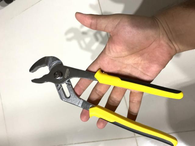

Hi, I am trying to replace my  kitchen sink mixer tap(faucet) , first is i need to be able to unscrew the hexagon nut before i could complete the replacement process till eventually tighten the hexagon nut again.
The problem is the hexagon nut is very big, not the normal cold water faucet nut that i can use the normal sleeve wrench to open it. Any clue would  be appreciated.

Go buy this, plumber tool

You'll need a pipe wrench of the correct size. That, you have to find a way to measure or just try different sizes.
The longer wrench may be useful. Mustafa sells them.
They come with a hole for you to insert a rod to tighten/loosen.
The hex end can also be used for tightening/loosening.
Thanks, I have this but not enough space, the gap behind the sink is too deep and too narrow, plus unable to grip properly as well.
Thank you. I have a one foot pipe wrench , it fits cold water tap but too small for mixer type, I will go Mustafa to take a look.
I know your problem.
You need a longer reach piece. AND make sure it fits. Else u may end up rounding the mixer .
The other way is to get a long screw driver that is suitable to clear the working space. Insert it into the hole to twist it.
Mine was really bad till I had to borrow a torque driver to drive out the nut.

TS, your 2nd pic shows you already got the tool. You just need a screw driver to push through the holes to turn it.

Can this help? Adjustable basin wrench. Not sure the mouth wide enough for your case.
Product: https://www.lazada.s...96-s278031.html
Thanks. Looks viable. I will try to look for a pipe wrench that could fit first before I explore this one.

Get one side bigger "Sleeve wrench". You can find them at those traditional or hardware shop doing basin/plumbing not those homefix in shopping mall.
Jalan besar you can find them.
Alternately try use rubberband (not condom) to go round the edge in loop. See whether can get any grip to lossen the nut.

Last resort when nothing to lose. Use a hammer to tap the old faucet on the tip clockwise while holding/blocking the nut below. This will sufficiently loosen till can finger unscrew.
I had to do this to replace a faucet that was leaking, and the hexagon nut below was corroded. I could not get any grip using wrench and the rust had acted as glue. Hammering from top had the effect of unscrewing from bottom.

Suggest to get the adjustable basin wrench as shown in earlier post.
Had one at home. Got it at a traditonal hardware shop.
Seldom used as dont change water tap often. But very handy when needed.
Dont have to twist back, twist neck, hand to change water tap. [rolleyes]

Basin wrench [thumbsup]
I have the adjustable jaw (basin wrench) wrench, but it's flimsy and difficult to use.
In tight space, you have to keep holding the jaw or turning it over, if you find it going in the wrong direction.
What you need is a fixed diameter socket that don't open up at the wrong time, while you're trying to move the tool.
I'm not sure the correct name, but it seems to be called shower socket wrench.
This is the best for tight space and you can exert plenty of torque.
