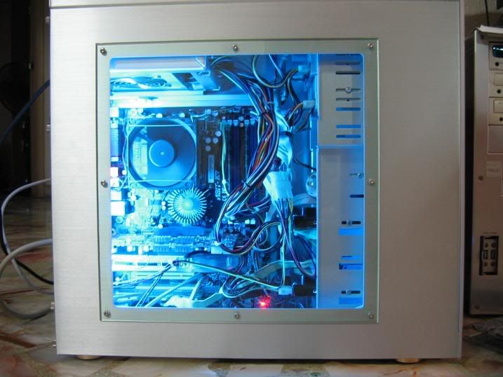

York Clutched December 9, 2005 Share December 9, 2005 (edited) cathode tube is cool...but the transformer module's hot....careful wif it...especially when u used both outputs... cos mine...one of the plastic socket melt.... I m using for casing's window pix; http://img.photobucket.com/albums/v369/yorktan/praet.jpg Edited December 9, 2005 by York Link to post Share on other sites More sharing options...
