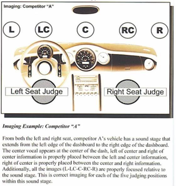

Bobcatsysop Neutral Newbie January 20, 2007 Author Share January 20, 2007 Here is one sample pix of what the IASCA judges are looking at based on U.S. LH drive cars. Dunno how to tune to suit BOTH driver and front passenger to have exact same imaging..Whew!!! Link to post Share on other sites More sharing options...

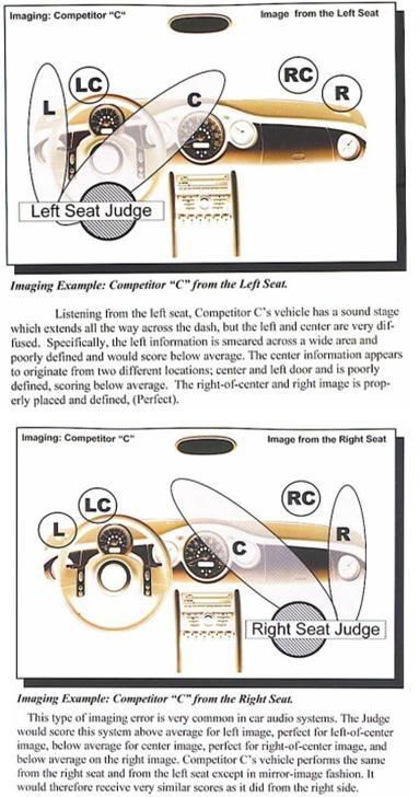

Bobcatsysop Neutral Newbie January 21, 2007 Author Share January 21, 2007 (edited) <> With additional centre channel or speakers, you may likely get into this situation? confusing leh (pix shown is US left hand drive cars hor..) Edited January 21, 2007 by Bobcatsysop Link to post Share on other sites More sharing options...

Tazster_t Neutral Newbie January 21, 2007 Share January 21, 2007 <> With additional centre channel or speakers, you may likely get into this situation? confusing leh (pix shown is US left hand drive cars hor..) Not sure if I'm reading you right, but the pic does not portray the existance of a centre speaker. What the pic shows is that the 6.5 woofer is.. like 'giving aways its position' or not firing its music to the same level as the soundstage.. so certain frequencies get smeared downwards towards the woofer. Link to post Share on other sites More sharing options...
Tazster_t Neutral Newbie January 21, 2007 Share January 21, 2007 Sorry bro.. i borrow this image for a while.. Based on what I've listened so far. If you have a normal setup.. what you would get most of the time will be something like this... Driver seat.. no issue right? In Passenger seat, your L, LC, C & RC will span from left a-pillar to centre console. R will be roughly be in the same position. ↡ Advertisement Link to post Share on other sites More sharing options...
