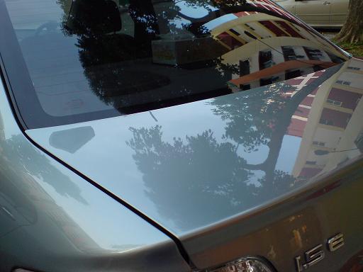

Beei 1st Gear March 4, 2007 Share March 4, 2007 After getting my car for 2 months, finally decided to wax my car for some shineness So today, wake up at 5.45 am. Gather equipment, I started at 6 am to wash my car with Turtlewax F21 (green liquid) car wash. Using a 3M sponge and turtlewax fibre cloth for drying. Then using a claybar and Meguiars quik detailer(red bottle, smell nice), I begin to claybar my car and dry off. Took me an hour. Realised there is some 'dents' on the paint caused by bird dropping and tree sap Waited for a while, I used the Meguiars NXT Spray Wax(purple bottle) for waxing. Read from here that this is also a sealant also. Spray a lot on the roof of my car and using a dunno what brand polish cloth, realised I spray too much. So i reduced the amount on other places. Then waited 5 minutes. Then buff off with another polish cloth. Very difficult to do so and i realised that the wax is still wet. So I waited for another 15 minutes and buff off again. Very easy now. However I seemed to find that the surface even though shiny now, does not look very smooth. What did I need to do to make it smooth? To all bro and sis, will polishing help in making it smooth? Or do I need to claybar with soap water instead with quik detailer? ↡ Advertisement Link to post Share on other sites More sharing options...
Beei 1st Gear March 4, 2007 Author Share March 4, 2007 (edited) noticed that my car backside seemed not smooth enough Edited March 4, 2007 by Beei Link to post Share on other sites More sharing options...
Gen2 Neutral Newbie March 4, 2007 Share March 4, 2007 (edited) Hi Beei, claying with QD should get a better result as compare to using soap water and if done properly, the surface should feel very smooth after you applied the NXT spray wax. Assuming you have clayed correctly, the only reason why the surface is still not smooth is you have applied way too much wax on the car and you did not buff off the residue completely . Btw from the photo, it looks pretty alright to me. Edited March 4, 2007 by Gen2 Link to post Share on other sites More sharing options...
