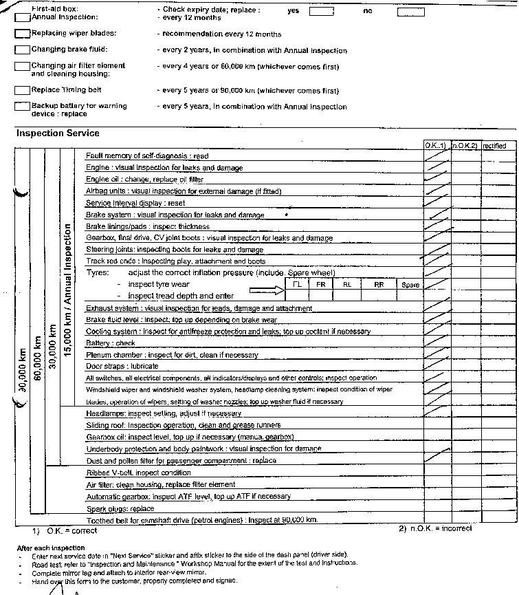

Veron Neutral Newbie January 26, 2003 Share January 26, 2003 Hmmm....seems like CA has different practises from other companies. Their 30K, 60K n 90K services are the major ones. I've scanned in the checklist for those who're interested. Just did our 30K servicing for our slightly more than 2-yr old Octavia 1.6 GLXi(Auto) with 30+K mileage. The charges r as follow: Labour $132 oil filter $15 blower filter element $21 air filter $30 battery water $1.8 Mobil 1 5W-50 fully synthetic (4.5L) $94.50 repair tyre $10 Total $316.47 The parts are almost double of buying ourselves (as compared with Octaviafan's), and the labour charges . But we're just not comfortable with going to outside workshops ↡ Advertisement Link to post Share on other sites More sharing options...
