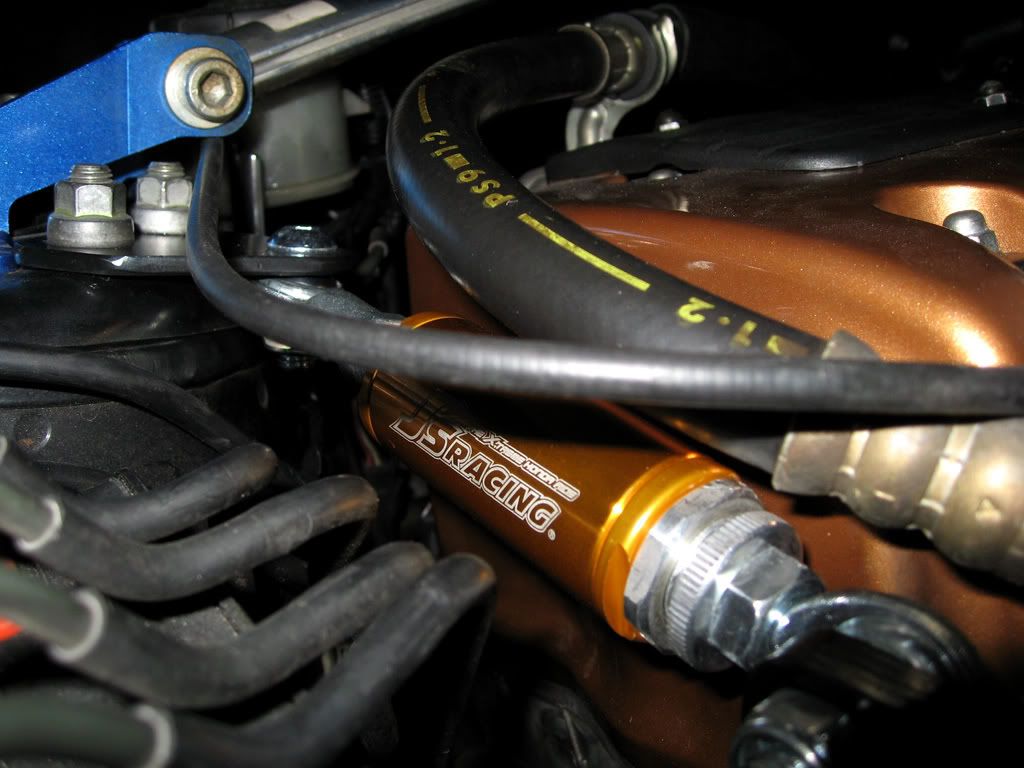

Wolverine Neutral Newbie September 14, 2005 Share September 14, 2005 Where can i get such a hydroulic piece to act as a damper? ↡ Advertisement Link to post Share on other sites More sharing options...

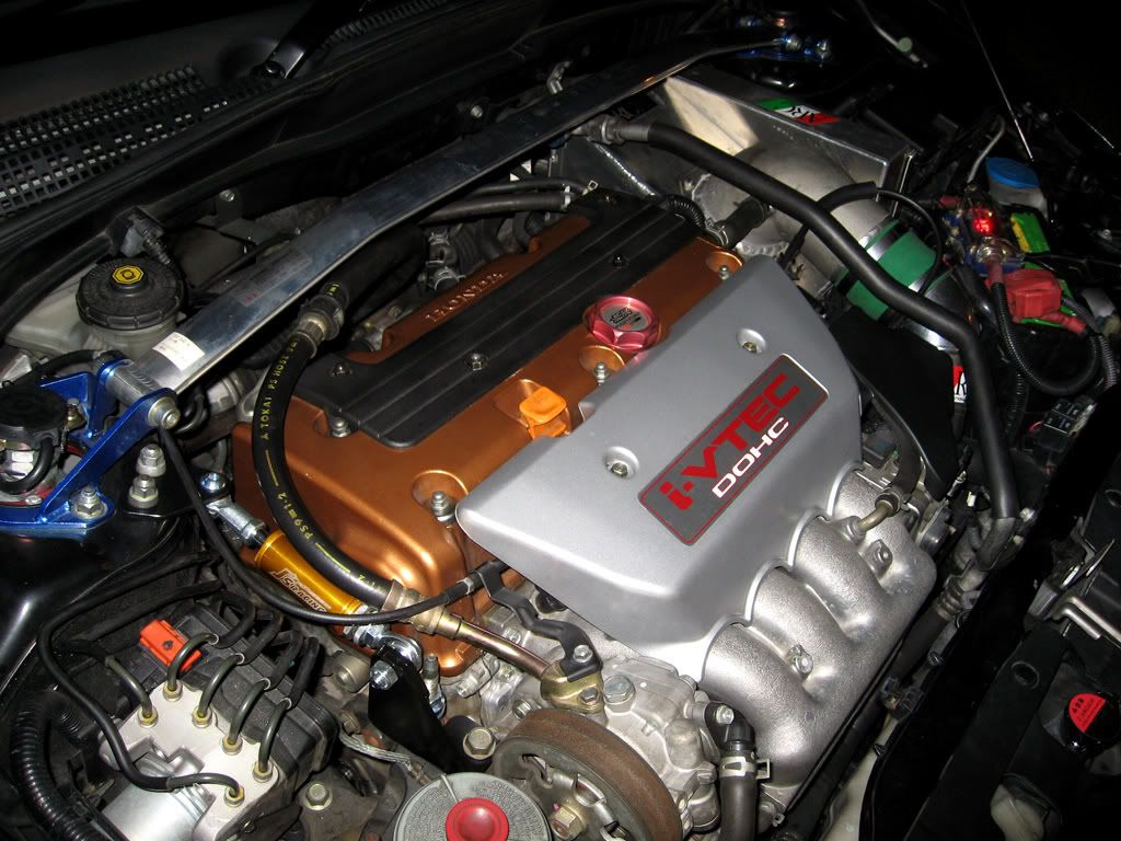

Genie47 1st Gear September 14, 2005 Share September 14, 2005 I've been told these are pretty good things to have too. Link to post Share on other sites More sharing options...
Jhoo Neutral Newbie September 14, 2005 Share September 14, 2005 So this thing works on our typical sg cars and not snake oil? Link to post Share on other sites More sharing options...
Genie47 1st Gear September 14, 2005 Share September 14, 2005 Well, it is nice to have but not necessary. Link to post Share on other sites More sharing options...
Saaber Neutral Newbie September 14, 2005 Share September 14, 2005 if you like have hand and body massage from the steering wheel and seat then this is the thing to have... Link to post Share on other sites More sharing options...
Ghostrider 3rd Gear September 14, 2005 Share September 14, 2005 It helps sharpen the throttle respond...but at the expense of shake rattle and roll.... Unless heading for track...more of a feel good mod rather than a performance mod. I used to have it on my Civic...all I can say is...GOOD AH !! But everytime the VTEC engages, you also can feel it. Wife hates the harshness though. Link to post Share on other sites More sharing options...
Caterpillar Neutral Newbie September 15, 2005 Share September 15, 2005 Believe is a steering damper use in the motor cycle. You can shop this at Lim Ah Boy (LAB) at Kelantan Lane. Link to post Share on other sites More sharing options...
Seetoh Neutral Newbie April 27, 2009 Share April 27, 2009 Sorry for bringing up this old topic... Any bros know got where sell and install damper? My car do not have the model yet.. any one know where to get those universal type? Thanks bros..... Link to post Share on other sites More sharing options...
Xiaogary Neutral Newbie April 27, 2009 Share April 27, 2009 I do know of a friend who distributes such dampers for industrial machines uses. But its similar to those used in cars, or rather exactly the same. Saw a few hondas having same damper in their ride before. I customised one for my ownself. Costed me $80+ (sing dollar) to customise the bracket and 1 hour+ in the workshop. You really can feel the torque increase in pickup. More solid pull feeling. It dampen the vibration and put more torque onto the wheels rather than energy lost due to shaking of the engine. Similar to uses in industrial, dampen vibration and put more torque in those mixer machines. But I think this thing is not cheap now. Due to high US currency now. Mine costed me $150 that time when US is low, now US super high, should be abt $170-180 I think. He buy in in bulk, so cheaper compared to you buy one or two pieces from car workshop, $220 I saw before in a famous shop in Ubi. Good project to do, compared to those no brainer plug and play item. Such customisation job bring more satisfaction. Haha... Link to post Share on other sites More sharing options...
Seetoh Neutral Newbie April 27, 2009 Share April 27, 2009 Thanks bro for info... Bro, you buy universal damper or any damper will do? If any damper, can anot? Just customise the bracket? Thanks bro..... Link to post Share on other sites More sharing options...
Xiaogary Neutral Newbie April 27, 2009 Share April 27, 2009 Thanks bro for info... Bro, you buy universal damper or any damper will do? If any damper, can anot? Just customise the bracket? Thanks bro..... Not any damper. Depends on length. But the one I got is length adjustable, so that can customise onto my car. If you buy any car's damper, it will be a headache if not long enough or too long. This kind of damper is very hard, inside is a kind of plastic or rubber that your hand push or pull also cannot move type. But once onto the engine bay, you can see it move a bit. You can imagine the power of the engine shaking. Yes. Bracket can customise one. At most 2 hours job at most shop. Need welding tools though the workshop you select. Link to post Share on other sites More sharing options...
Vblaster_w211 2nd Gear April 27, 2009 Share April 27, 2009 Torque damper is useful if you tend to pull your engine, and if your engine generates a good amount of torque. Best to try out a car first as you may not get used to the vibrations when idling. It's effects can be felt when driving - more crisp response as the engine does not move as much when revving. At the dyno, I can see the engine block remaining relatively still whereas in the past, the pulls past VTEC will cause the engine to lurch. Link to post Share on other sites More sharing options...
Circuit Clutched April 27, 2009 Share April 27, 2009 wats the damage? can pm me? and place to do it up? universal? Link to post Share on other sites More sharing options...
Rb26dett Clutched April 27, 2009 Share April 27, 2009 actually i would like to ask , how effective is this engine torque damper ? i mean sorry for noob question.cos i've heard from 2 type of users , one with those harder engine mountings and anotther with these torque dampers.and both type of users aim at 1 common result. better and more direct transfer of engine torque to the wheels.so actually which is better and more efficient. lets say i am not concern about the vibration/sound/bla bla .i am currently using the cusco engine mountings and they are very very stiff.can really feel the engine movement even on idling..so installing such dampers , does it 1) improve the vibration ? 2) retains the "more" direct transfer of torque that my cusco engine mountings offer? Link to post Share on other sites More sharing options...
Vblaster_w211 2nd Gear April 27, 2009 Share April 27, 2009 Racing engine mounts and torque damper are designed for the same purpose. Get one or the other. Usually don't need both. ↡ Advertisement Link to post Share on other sites More sharing options...
