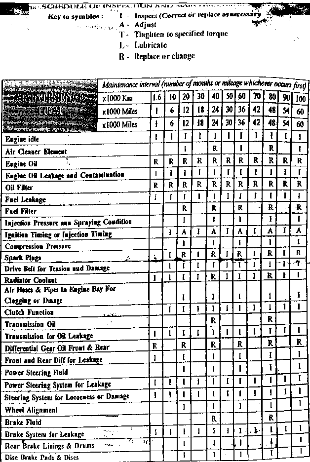

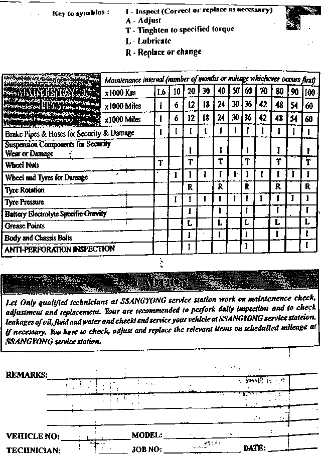

Veron Neutral Newbie April 23, 2002 Share April 23, 2002 I got the list from Alex during our last servicing at JTA. Quite a lot of things to replace for 40K. I'd try to scan it n attach the file next time. Link to post Share on other sites More sharing options...

Veron Neutral Newbie April 23, 2002 Share April 23, 2002 (edited) The files as promised Edited April 23, 2002 by Veron Link to post Share on other sites More sharing options...
Veron Neutral Newbie April 23, 2002 Share April 23, 2002 Paiseh to take up so much space. I thot the attachments will come out as filenames only. Link to post Share on other sites More sharing options...
Skoda_Man Neutral Newbie April 23, 2002 Share April 23, 2002 Wah lau, 40K got so many stuff to replace????!!!!!! Die liao. Money not enough Link to post Share on other sites More sharing options...
Turbobrick Neutral Newbie April 23, 2002 Share April 23, 2002 No prob, better to see it here since it'll take up the same space on server Link to post Share on other sites More sharing options...
Sky8807 1st Gear April 23, 2002 Share April 23, 2002 Not so many, only 9 items, including engine oil, oil filter, fuel filter, air filter, trans oil, brake fluids, plugs, coolants. Look normal to me. Except a little more inspections required, that all. No worries, no scat no scat. Link to post Share on other sites More sharing options...
