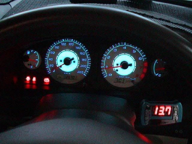

Bobcatsysop Neutral Newbie February 20, 2007 Share February 20, 2007 (edited) Hi Bro, If you are serious in doing grounding, the big 3 points as pointed out by bro Headshok are the most important. I did another 1 for ECU grounding to make it 4 points. I also have one additional direct awg4 direct from battery negative to undercarriage of the mid-body and rear grounding points so that my rear amps and rear capacitor gets a direct highway all the way back to battery negative instead of via body chassis. To know if the grounding helps or not, I recommend you install a $25+ worth of digital voltage meter (not analog meter) that tap power direct from fuse box (not from cigarette lighter socket). If you can get constant voltage of 13.8v running, your ICE is going to operate at optimum level. Then, you check the voltage (not in the morning start that shows like 14.2v or 14.3 volts that is not the accurate voltage). You monitor it at night on a rainy day with all your headlights on, rear demister on, aircon on, etc... then you see what voltage reading you get. See if you are getting 13.7v or 13.8v. If not, check how old is your battery right now and how old is your car (coz alternator life is also a factor for doing the job of charging), then you know what to replace or upgrade. A ballpark figure for amps to operate at optimum level is 13.8v for you to shoot for. If you are using a Pioneer P80 head unit, there is a battery voltage display that provide real time voltage reading thus, you just have to use this display to show your battery voltage saving you the trouble to install a digital voltage meter. Edited February 20, 2007 by Bobcatsysop Link to post Share on other sites More sharing options...

Dopod78 Neutral Newbie February 22, 2007 Share February 22, 2007 Hey thanks for the reply bro. yeah me at work already... wat a bitch! All these traveling doesn't leave me with much time to play with my toys hahaha. Wat to do if i don't work then i cant buy new toys. Thanks for the help given so far bro. Appreciate your replies. Hey another thing. You mentioned the $25 digital gauges. Where can i get them back home? Link to post Share on other sites More sharing options...
Bobcatsysop Neutral Newbie February 22, 2007 Share February 22, 2007 Hi Bro, Work is more important... Yeah.. you can buy the $25 (dunno if this is still the same price today) digital voltmeter from Asia Elite Tools subsidiary of ATC Tech Pte Ltd. 20 Ang Mo Kio Industrial Park 2A, AMK Techlink #02-14 Singapore 567761 just next to AMK Autopoint Tel: 6484-3431 Ask for Wendy. AM2801 Digital VOLT METER: http://sg.pg.photos.yahoo.com/ph/doc_star2...d&.dnm=94c6.jpg Link to post Share on other sites More sharing options...
