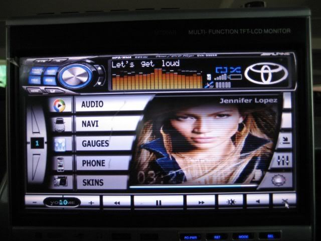

Darthrevan Supercharged July 28, 2010 Share July 28, 2010 Is the controls using touchscreen? or using keyboard/mouse? Link to post Share on other sites More sharing options...
Krazz77 Neutral Newbie July 28, 2010 Author Share July 28, 2010 Is the controls using touchscreen? or using keyboard/mouse? touchscreen. keyboard and mouse only used when needed. Maybe to install or copy files. Link to post Share on other sites More sharing options...

Krazz77 Neutral Newbie August 6, 2010 Author Share August 6, 2010 (edited) I think I read somewhere Ipad dash kits are already available for certain car models. So far my CarPc had been stable & I haven't done much for the past yr., only fiddle to get SQ perfection. Unfortunately, my quest for the perfect SQ through CarPC is still going nowhere. I guess I don't have to ears for audio tuning & I just thrown in the towel & got myself the MS-8 processor. Hopefully I can get the perfect SQ & stop meddlng with my car again. Haha... My next few wkends wil be doing all my audio stuffs & setting up my brother's CarPC. Also I'll get somehing to post on your blog, here's some of my old install pics. : If i remember correctly, you are the guy with the llliput for sale right? Great job on your toyota wish i must say. One of these days i must be able to fabricate the dash like yours. A truly OEM look. Ermm .. wat's the MS-8? Last time i heard i think you guys are into USB DAC stuff right? Think you are using road runner font end? I tried but had quite a few problems... It always freezes on my rmvb videos with a "subscript 9" error... Googled and people say it's codec related (i'm using klite) .. so it's still back to centrafuse for me now. Edited August 6, 2010 by Krazz77 Link to post Share on other sites More sharing options...
