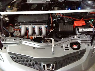

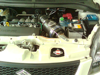

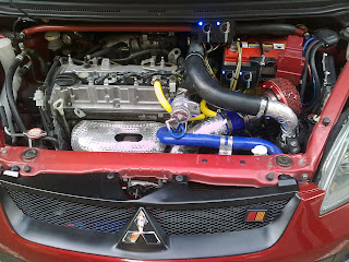

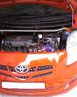

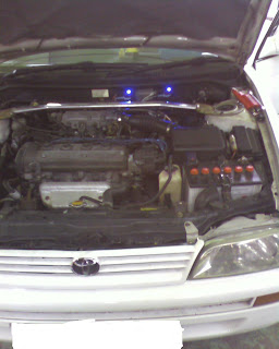

Karebu 1st Gear December 4, 2010 Share December 4, 2010 actually when i saw the blog i was trying to figure out what is it that he is trying to sell.... its quite interesting though funny how ppl would buy his stuff. i laughed though its expected when his testimonies (shots of engine bays) have the typical stuff. simota la. what charger la. stunt bar la. hmm okay.. endless photos. geez. cant believe how many ppl install such crap. Link to post Share on other sites More sharing options...
