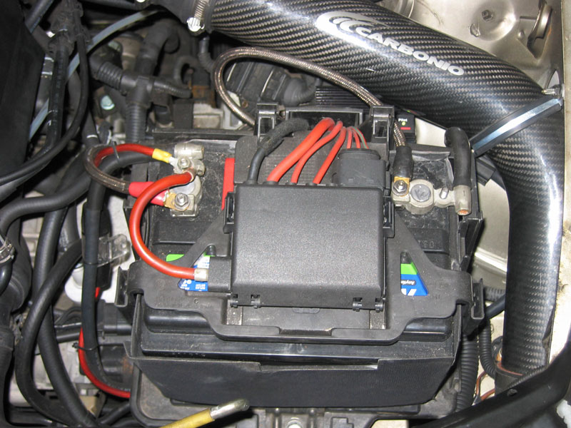

Lightspeed Clutched June 16, 2005 Share June 16, 2005 Can't help you on the Superb... unless I can catch hold of Conned to snap some pics... but for the benefit of the rest... here are the pics of the fuses for the Octy Battery Cover [inline IMG_1787.jpg] Batter Cover removed [inline IMG_1788.jpg] Fuse box opened [inline IMG_1792.jpg] Link to post Share on other sites More sharing options...
Fortress Clutched June 16, 2005 Author Share June 16, 2005 Hi, Thanks a million for the picture, got it. It seems there are more stuffs just below, you can find the 2 bolts there, will update you on that this weekend. Ivan Link to post Share on other sites More sharing options...
Fortress Clutched June 28, 2005 Author Share June 28, 2005 (edited) Hi, Sorry for the late reply, only managed to do the change yesterday. And thanks for the pictures of fuses and prompt reply. Understand that a relay helps to switch the fan and off depending on needs, hence, I concluded it is the relay and not fuse. Managed to resolve the issue of the fan relay, there is a loose connection in the socket (see attached) due to a crack in the plastic connector, which I have fixed back with added reinforcement(tie-wrap). I have also managed to de-carbonise the fan with contact cleaners to remove carbon. FYI. Ivan Edited June 28, 2005 by Fortress Link to post Share on other sites More sharing options...
