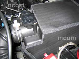

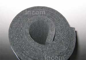

Incom 1st Gear October 29, 2005 Share October 29, 2005 (edited) Hi there, I am also using thermal shield material to insulate my airbox as well. You should be able to get the material from aircon shops. Cost about $10 for a sheet of 1m x 1.2m, with 10mm thickness. Below are some pictures for your info: Cheers Edited October 29, 2005 by Incom Link to post Share on other sites More sharing options...

Anders213 Neutral Newbie October 29, 2005 Share October 29, 2005 How you stick the armaflex to the airbox? Link to post Share on other sites More sharing options...

Incom 1st Gear October 29, 2005 Share October 29, 2005 3M double-sided tape. So far so good, no signs of melting of the tapes. Btw mine is insulflex which is the same as armaflex. Thanks Cheers Link to post Share on other sites More sharing options...
Incom 1st Gear October 29, 2005 Share October 29, 2005 Got it at one of the aircon shops in UBI area, but i have lost the address. Will post once i found it. Cheers Link to post Share on other sites More sharing options...
