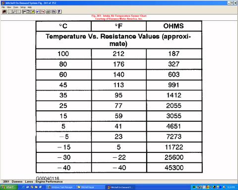

Hattee Neutral Newbie February 25, 2006 Share February 25, 2006 IAT sensor essentially is a thermistor. Its resistance changes from 3.5kohms at 20 Link to post Share on other sites More sharing options...

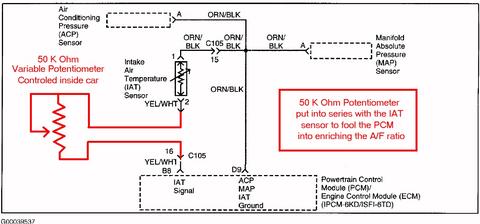

Genie47 1st Gear February 28, 2006 Share February 28, 2006 (edited) What the hell are you smoking? IAT hacks help? With this kind of weather you are going to screw the AFR bad. People in the US have tried it and it sucks. Wet blackened plugs. These things don't lean out, these things richen the mix. See below. Most of these things have set the resistance to very high. That makes it run rich. You need a potentiometer to hack it run leaner by reducing the resistance. Air intake temperatures range from 35-45 deg C. eBay ones don't have any lower resistance. Then again fooling it to run too lean will have disastrous consquences and nobody can afford that because these cars are our daily rides. If anyone wants to play, be warned. The second picture shows how I would hack it. OK I will explain in more detail about this resistor hack. The IAT is a thermosistor. So hotter = lower resistance. So the best way is to use another resistor (higher resistance) to take some of the current to ground making it falsely read it higher. To make it lean what you are going to need to do is find how to SLIGHTLY decrease resistance by that voltage into signal out. You will need a BIG resistor for this. Forget these things. SAFC is better. It has maps. Edited February 28, 2006 by Genie47 Link to post Share on other sites More sharing options...

Maded Neutral Newbie February 28, 2006 Share February 28, 2006 Second diagram is interesting... could rig it up to be controlled with the throttle... more throttle = richer, less or no throttle = stock. But wouldn't the O2 sensor pick this up and adjust accordingly? Another idea would be to fool IAT, MAP and O2 sensor... but this is MAJOR hacking... Link to post Share on other sites More sharing options...

Genie47 1st Gear February 28, 2006 Share February 28, 2006 The diagram courtesy of Erfinder@PrecisionBoost at Daewootech.com. Link to post Share on other sites More sharing options...
