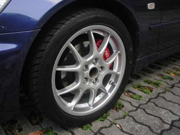

Yaloryalor 5th Gear August 20, 2007 Share August 20, 2007 I see.. For the past few times when I change my rims, I only consider the rims need how many nuts ( example 4 or 5 nuts per rim). You changed your rims? Can post some pics to share with us? Link to post Share on other sites More sharing options...
EventH 1st Gear August 20, 2007 Share August 20, 2007 [inline EPSN0007.jpg] Link to post Share on other sites More sharing options...
Yaloryalor 5th Gear August 22, 2007 Share August 22, 2007 Thanks for sharing! You din lower IS200 pa? These days, chrome rims are very popular! Link to post Share on other sites More sharing options...
EventH 1st Gear August 23, 2007 Share August 23, 2007 not chrome ... stock car ;) just some minor mods to stiffen the chassis. I heard in lowering cars, the centre of gravity might be shifted too far relative to the roll centre of the car. Like that not good for handling also. ↡ Advertisement Link to post Share on other sites More sharing options...
