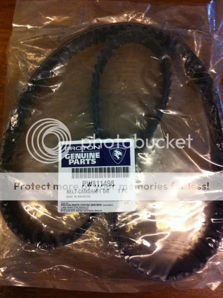

Panhard 1st Gear February 25, 2013 Share February 25, 2013 (edited) These are the recommended original parts used for Exora timing belt replacement: 1. PW811498--timing Belt (01 pc) 2. PW811558--camshaft oil seal (02pcs) 3. PW811011--crankshaft oil seal (01 pc) 4. PW811497-- timing belt tensioner (01) 5. PW811696-- tensioner bolt (01) Edited February 25, 2013 by Panhard Link to post Share on other sites More sharing options...

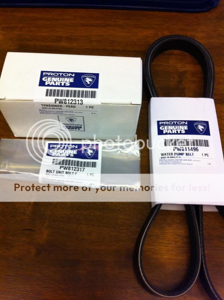

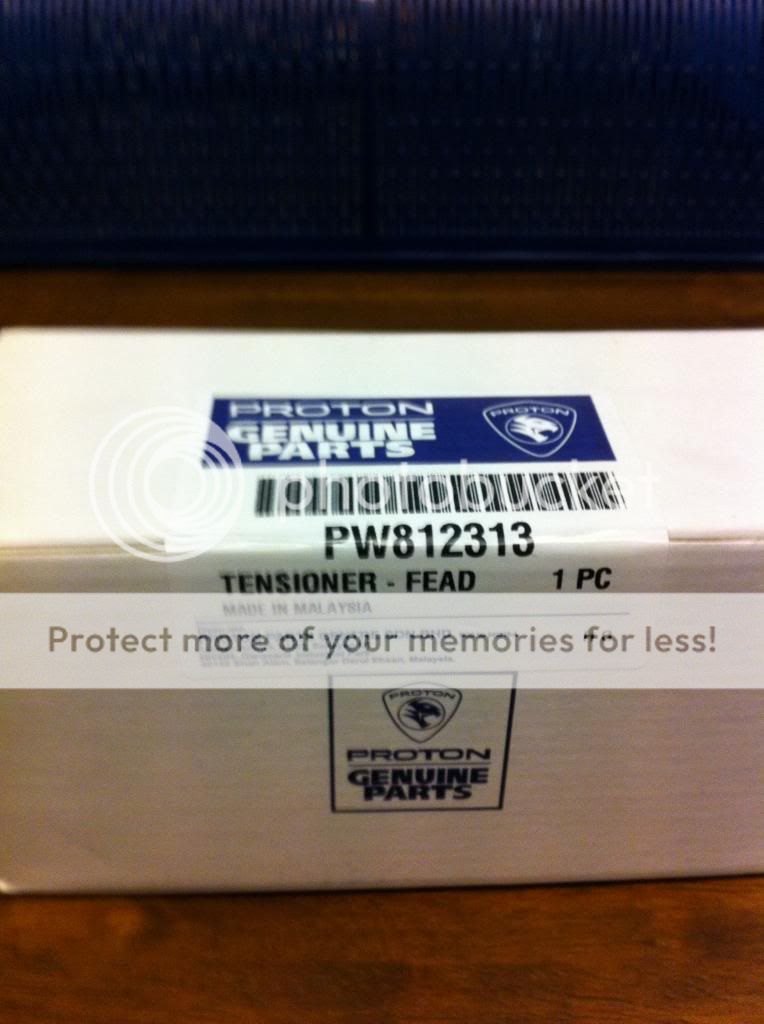

Panhard 1st Gear February 25, 2013 Share February 25, 2013 (edited) These are the recommended original parts for the external belt. 1. PW811496--water pump belt (01pc) 2. PW812313--tensioner (01pc) 3. PW812317--tensioner bolt (01pc) Note: For those experiencing noise when engine cold, the new tensioner PW812313 is now used in replacement of the old part which is better. Edited February 25, 2013 by Panhard Link to post Share on other sites More sharing options...

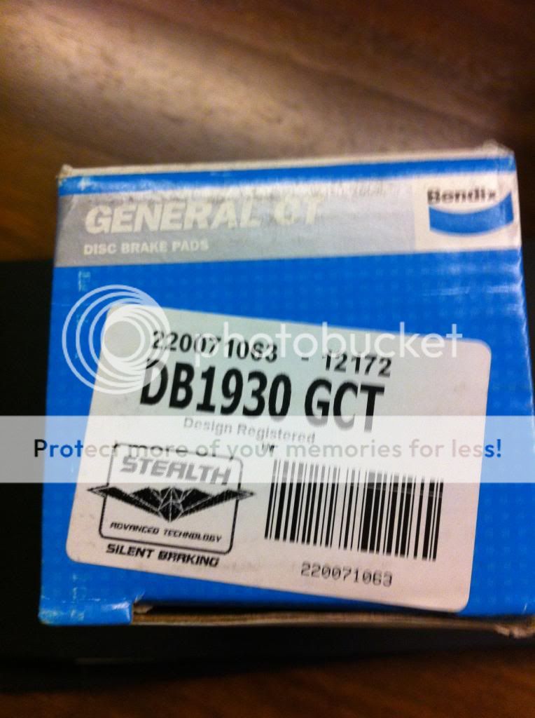

Panhard 1st Gear February 25, 2013 Share February 25, 2013 For any exora owners who want an alternative to the original front brake pads. I strongly suggest these from Bendix: General CT --DB1930 GCT Link to post Share on other sites More sharing options...
SGXora Clutched February 25, 2013 Share February 25, 2013 Hi Panhard, when should i change the timing belt ? Link to post Share on other sites More sharing options...

Meganut 2nd Gear February 25, 2013 Share February 25, 2013 Timing belt for most msian cars in general are about 80k. Take note of bendix brake pads, i been using it for 2 years, its known as a metal king, some owners may experience scratches or even damage to their brake rotors, cos it may 'eat' the metal parts of your brakes... i have switch to stock pads since and i change my stock pads every 10-20k mileage depending on how the braking feels... Bendix is a good product you will find an increase braking power of about 10-15% better.. I will be in JB this weekend to help one exora brother to buy armreat, if you guys need any specific parts can lemme know, i can pick some from the distributor otw home Link to post Share on other sites More sharing options...
