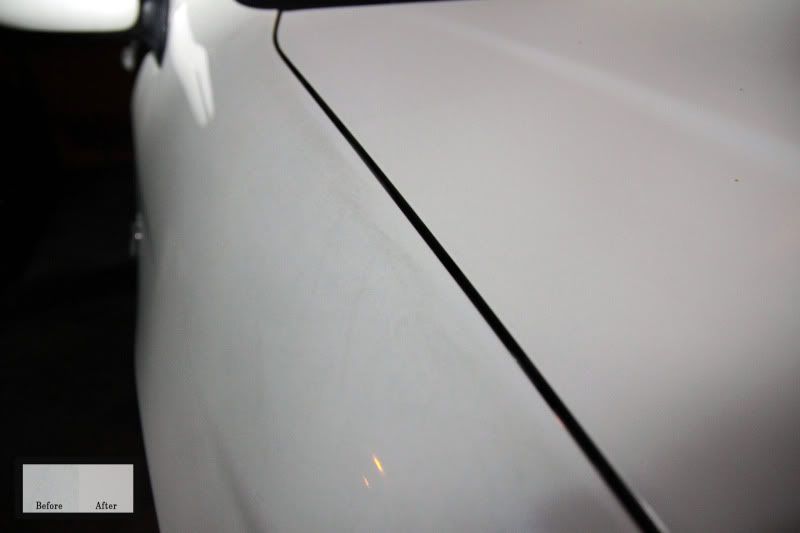

Joshux Neutral Newbie July 23, 2012 Share July 23, 2012 Here you go Link to post Share on other sites More sharing options...
Joshux Neutral Newbie July 23, 2012 Share July 23, 2012 Yup, you can see that the left panel is before claying, and the right panel is after. Link to post Share on other sites More sharing options...
