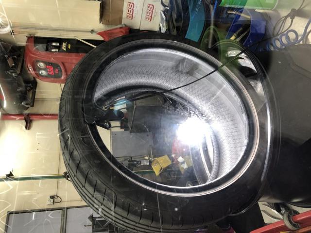

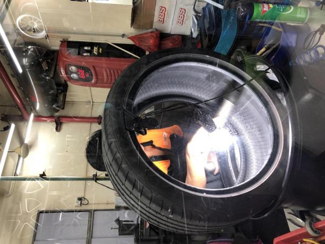

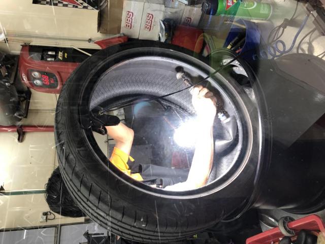

Theoldjaffa Hypersonic June 14, 2019 Share June 14, 2019 Just to share my experience with tyre patching. In my 18 years of driving, I've had a fair share of nails but they have all been slow leaks and I've always used worm patching. TPMS alerted a low pressure on Tuesday, so I went to do a worm patch as usual at the petrol station workshop just outside my place. But I decided to try internal patching today at Southeast Tyres. 10/10 to them and it's worth every cent! here's the process: First the worm is taken out and the Tyre is ground with a "stone" Next, use a metal brush to scrub off residual stuff Vacuum the shards away Spray some alcohol like stuff on the area Rub in some tar like paste The boss saw the worker's work, wasn't satisfied. Did it himself! Used a drill to drill out residuals. Great commitment to doing a sweet sweet job Patch is in Knead the patch down Apply some more tar stuff around the patch Cut off the outside and it's done! 13 Link to post Share on other sites More sharing options...

Knoobie Supercharged June 14, 2019 Share June 14, 2019 Just to share my experience with tyre patching. In my 18 years of driving, I've had a fair share of nails but they have all been slow leaks and I've always used worm patching. TPMS alerted a low pressure on Tuesday, so I went to do a worm patch as usual at the petrol station workshop just outside my place. But I decided to try internal patching today at Southeast Tyres. 10/10 to them and it's worth every cent! here's the process: First the worm is taken out and the Tyre is ground with a "stone" F2F5A47C-4831-44EB-B1DA-9671B7F6DF29.jpeg Next, use a metal brush to scrub off residual stuff 4ABDD937-AE90-40EE-8FB6-73E37D69CE97.jpeg Vacuum the shards away E4F28A1D-B6AB-42D8-AA51-C4947C91733B.jpeg Spray some alcohol like stuff on the area B2C8B7EE-5DDE-4A67-ACA6-83151CDC58FA.jpeg Rub in some tar like paste EB52C741-EAFC-4830-BA62-5F796F9174D8.jpeg The boss saw the worker's work, wasn't satisfied. Did it himself! Used a drill to drill out residuals. Great commitment to doing a sweet sweet job F63FD405-45A5-40E0-9D07-FE64BFF2EA7D.jpeg Patch is in 85E11C6C-618E-4A19-8E82-9D98C8B5FA98.jpeg Knead the patch down 6EE1EEB5-FD87-4A02-83F9-5A2281BF2885.jpeg Apply some more tar stuff around the patch 7E118410-BB79-4EFB-ADE3-166588440275.jpeg Cut off the outside and it's done! 45077DE1-FAAE-496B-AD17-BB78C092ACEE.jpeg appreciate your sharing.. but my neck hurts after going thru your post!! Link to post Share on other sites More sharing options...
