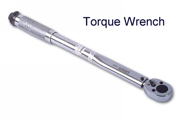

Yeobh 4th Gear May 3, 2006 Share May 3, 2006 (edited) Here is professional torque wrench designed for low torque range Edited May 3, 2006 by Yeobh Link to post Share on other sites More sharing options...
