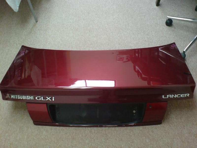

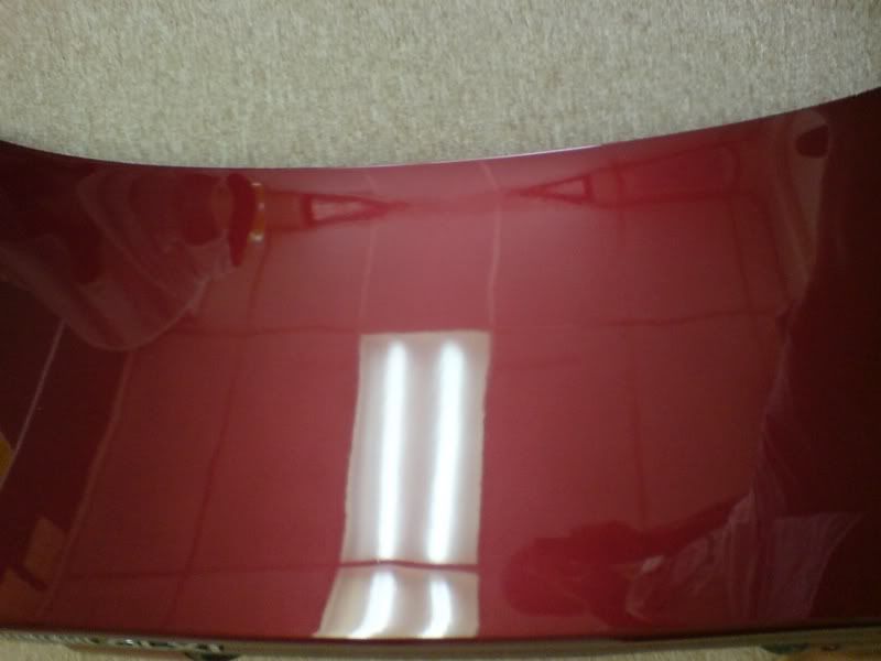

Teo_jason Neutral Newbie April 2, 2007 Share April 2, 2007 Just got a porter cable last week and managed to get a 15 year old mit lancer rear bonnet for test for my PC before using on my car..... quite fun and easy to use i would say but makes quite a lot of noise.... i managed t try it with different products mainly,menzerna IP ,Optimum Hyper compound, optimum compound, optimum polish..... Below are the steps i took on the oxidized bonnet and pics: 1) Menzerna IP w/ orange pad at speed 5 on half the bonnet 2) Optimum Hyper compound w /orange pad at speed 5 on the other half 3) Optimum polish w/white polishing pad at speed 5 on the whole bonnet 4) JW prime w/ grey color pad at speed 3 Results: Managed to restore glossiness to the bonnet and remove the oxidation but there are still water etched marks on it that could not be removed.... ↡ Advertisement Link to post Share on other sites More sharing options...
