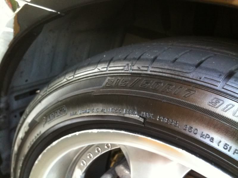

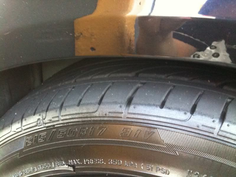

Dscheng 3rd Gear February 21, 2011 Author Share February 21, 2011 This is my tyre pic.. still have thread, but there is one chip off on my tyre side wall. Does this chip off cause any lose grip? Or is it dangerous? Stupid hump la.. Link to post Share on other sites More sharing options...
Dscheng 3rd Gear February 21, 2011 Author Share February 21, 2011 I think its the confidence and understanding of the limitation of TS tyre and car that is leading to TS stepping harder on the accelerator. My jazz origianl tyre(175/65R15) also spins like no tomorrow on wet cement flooring, especially up those sloping/spiral carparks. Just have to start off with momentum and maintain the engine power. Sudden power will cause the tyre to lose grip on wet flooring. Hmm.. my frd ever told me abt this logic before.. he say i step my pedal too hard during up the slope and the momentum must be right. Haiz. Link to post Share on other sites More sharing options...
Heartbreakid 6th Gear February 21, 2011 Share February 21, 2011 How much pressure you have in the tyres? If everything is right, the tyre compound really is in question. Link to post Share on other sites More sharing options...
Wolfy3769 2nd Gear February 21, 2011 Share February 21, 2011 we are talking abt tire here.. if u are not comfortable with the tire.. better change it... it is better that u end up with something else then u regards....a better tire shld solve most of ur problem.. kind of think abt it.. look like GY had this problem.. last time was using respev RS-02... also had this wheelspin problem... some friend tell me is because it is sport tire.. so it is softer (better grip).. so normal to have this wheelspin... but after 30K...i change to a GR80 (that time still have)...and no more wheelspin for me.. base on ur photo, i would consider the tire worn liao pass the 50% couple with the problme u having,i would probably change tire liao. imagine that time if u slip back and knock those car behiind u... Link to post Share on other sites More sharing options...
