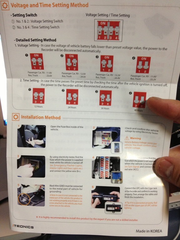

Calvincn Neutral Newbie December 13, 2012 Share December 13, 2012 Hi guys just inquiring, how do I power off the unit to safely remove the SD card as I have installed the UPC and wired up to the fuse box for 24hr recording ? Tried just turning off the car and removing the SD card but then the camera had the 4xbeeping even when i reinsert the SD card until I remove the power cable directly from the camera. Link to post Share on other sites More sharing options...

Heng 1st Gear December 13, 2012 Share December 13, 2012 Hi guys just inquiring, how do I power off the unit to safely remove the SD card as I have installed the UPC and wired up to the fuse box for 24hr recording ? Tried just turning off the car and removing the SD card but then the camera had the 4xbeeping even when i reinsert the SD card until I remove the power cable directly from the camera. I have not done this yet. But I plan to install a switch for the red cable of the UPC. I think this will help. Link to post Share on other sites More sharing options...

Heng 1st Gear December 13, 2012 Share December 13, 2012 I suppose you can get a switch from the car installer. If you use Itronics Uninterrupted Power Cable (UPC) to connect the ITB-100HD, you are not suppose to be able to switch off power even if the ignition is off so that the Parking Mode is continued. If it is not connected correctly to work this way, you don't need the UPC. So for those using UPC, the yellow (not red, I made a mistake earlier) cable is to connect to the fuse that is powering all the time whether the car ignition is on or not. If you put a switch to this yellow cable, you can then switch off for 2 purposes : 1. To remove the SD card, without unplugging and plugging the power cable 2, To switch off Parking Mode when you don't need it. There might be some occasions for this. I find this relevant and don't need all the time. Hope this helps. Link to post Share on other sites More sharing options...
Adrian_4781 Neutral Newbie December 13, 2012 Share December 13, 2012 whoowhoo~~...proud owner of ITB100HD also...:P i think the UPC not so difficult to fix up, maybe i shall fix it up myself tomorrow... Link to post Share on other sites More sharing options...
Adrian_4781 Neutral Newbie December 13, 2012 Share December 13, 2012 manual state connect one to the fuse where the power is supplied all the time though engine is off...easily can b check using multi meter... Link to post Share on other sites More sharing options...
