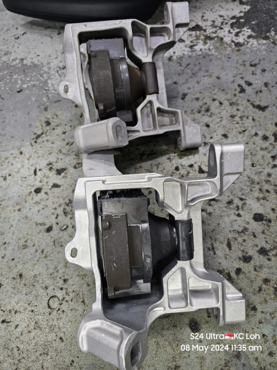

Axela525 4th Gear May 8, 2024 Share May 8, 2024 Send my car for 125k servicing at TEK agent, came back with a list of recommended repairs. Did not do it as I know agent always very high price. Seek 2nd opinion with KHY motor at Sin Ming Autocare. Boss name Ah How. Very honest safe money type, can don't change better safe money. He did a check and found only engine mounting and left drive shaft boot need to change. The rest all looks fine. Paid $580 for engine mounting and $150 for drive shaft boot. Test drive and now like new car. Idling now very quiet...always thought engine stall Strongly recommended for him to service your car and repair. No regrets!! Engine mounting 3 pieces ↡ Advertisement 7 Link to post Share on other sites More sharing options...

Axela525 4th Gear May 8, 2024 Author Share May 8, 2024 Top old mount, below new mount. Link to post Share on other sites More sharing options...
Axela525 4th Gear May 8, 2024 Author Share May 8, 2024 Using boiling water to clean the corrosion... Left new mount, right old mount, gaps very big! Link to post Share on other sites More sharing options...
Axela525 4th Gear May 8, 2024 Author Share May 8, 2024 Can see the crack on the mount...right side. Centre mount 2 Link to post Share on other sites More sharing options...

Axela525 4th Gear May 8, 2024 Author Share May 8, 2024 This is the agent report to change the parts...safe alot of money as certain parts still ok...think they got quota, to change parts to earn more money. Total paid for the mounting and the left shaft boot. Good Job! 2 1 Link to post Share on other sites More sharing options...
