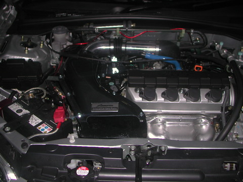

Civic_minded Neutral Newbie January 28, 2005 Share January 28, 2005 Bros, I just installed Simota Air Intake System...Any comments on this brand?? Will put up the photo soon for u guys to see....I personally find it quite cool... ↡ Advertisement Link to post Share on other sites More sharing options...
Kklim Supercharged January 28, 2005 Share January 28, 2005 Got one with a heat shield in my Matrix. Have had it for more than half a year and it works great. Love the growl when overtaking container trucks on the PLUS highway. Link to post Share on other sites More sharing options...
Wildboar Neutral Newbie January 28, 2005 Share January 28, 2005 The air inlet for the simota is quite small if I'm not wrong. Ur low to mid end should be quite shiok. Ur high end may lose out due to suffocation. Link to post Share on other sites More sharing options...
Lightspeed Clutched January 28, 2005 Share January 28, 2005 Hey bro... long time never see you post... Anyway Pat installed a Simota Carbon shielded Simota intake and did some custom piping... it was interested... The Simota thingy looks like the BMC CDA airbox ... Maybe I should've got the BMC CDA instead ... seems to make more sense to me than my current setup... Link to post Share on other sites More sharing options...
Nivlac Neutral Newbie January 28, 2005 Share January 28, 2005 apparently its nicely constructed but not techincally sound... as the intake is directly above the extractor HOT HOT... and as mentioned the scoup is rather small. I still strongly believe low and mid will not suffer infact sud be better. However at top spd... may suffer den again how often u hit top spd at ard 160kmh and above? Having said tat ... Vtec is meant to kick in at high rpms... so wif that restriction wouldnt u defeat the purpose of vtec? Hows the induction sound by the way? Moi almost installed it too... till heard the above ... and non-recommendations from other intake gurus... Anyway, do give us ur feedback... may still change my mind... keke Link to post Share on other sites More sharing options...

Civic_minded Neutral Newbie January 29, 2005 Author Share January 29, 2005 I totally agree with you...even with the heat shield, i find it very hot inside the air duct and the scooup is quite small as well...however, the good thing is that the opening of the intake lies just at the tip of the bonnet, so i assume that it will take in a lot of cold air from outside.Hopefully the cold air from outside are not heated up along the way into the engine..as i mentioned earlier that the air duct is very much heated up . Do you think further wrapping it with those heat-shield cloth will help? Btw, i don't really understand your part on vtec... The induction sound is fantastic....i notice that the growling actually invites many stares from other motorists Have a nice weekend bros.... Link to post Share on other sites More sharing options...
Civic_minded Neutral Newbie January 29, 2005 Author Share January 29, 2005 (edited) Just took a quick snap of the air-intake.....Have a look[inline simota.JPG]e Edited January 29, 2005 by Civic_minded Link to post Share on other sites More sharing options...

Civic_minded Neutral Newbie January 29, 2005 Author Share January 29, 2005 Bro, Is there any remedy to it? Was wondering yhy is it that i have different response from different users. Some say that with this setup, my low end will suffer but my high end will be good but some commented that the problem is with the high end. I only installed this thing for a couple of days and so far i find that my low and mid improved....but haven really tried high end yet..Will update once i try it. Link to post Share on other sites More sharing options...

Thepukster Neutral Newbie January 29, 2005 Share January 29, 2005 The reason why your high end will suffer is due to the fact that the opening of the air intake is rather small as compared to other open-pod filters (e.g HKS, Apexi, etc...)... Link to post Share on other sites More sharing options...

Civic_minded Neutral Newbie January 30, 2005 Author Share January 30, 2005 Actually, mine intake system is also an open-pod cone filter but it is wrapped by the heatshield. Maybe i should remove the black heat shield and do my own heatshield thereby not restricting airflow...Do u think its feasible bro?? ↡ Advertisement Link to post Share on other sites More sharing options...
