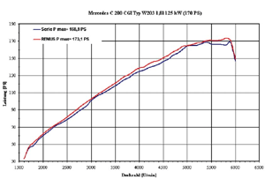

Lorrliew Neutral Newbie July 14, 2005 Share July 14, 2005 (edited) According to Remus website, there is some improvement, see attachment downloaded from Remus. Spoke to some exhaust specialist here also say the same thing, 3-5% improvement. Of course, changing the whole exhaust system is even better. Personally no expereince yet. Edited July 14, 2005 by Lorrliew Link to post Share on other sites More sharing options...
