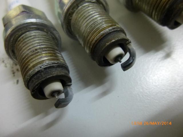

Fuelsaver Supercharged May 26, 2014 Share May 26, 2014 hi bros / sis, can comment on below sparkies pix, as i'm unsure how to interpret engine condition / combustion - TIA. Link to post Share on other sites More sharing options...
Pisces69 6th Gear May 26, 2014 Share May 26, 2014 hi bros / sis, can comment on below sparkies pix, as i'm unsure how to interpret engine condition / combustion - P1000771.JPG P1000772.JPG TIA. I cant see the pix u posted but general rule when inspecting yr plugs. Electrode tips sud not b worn down. Might b wrong heat range n plugs getting too hot. Tips sud have a nice tan coating. AF mix is good. Tips black n sooty cud b AF mix too rich or burning oil cos piston rings worn. Plugs can tell quite a lot abt yr engine. I always inspect my old plugs when put new ones in. Oh OK now I see the pics. Top pic looks slightly sooty. U need to take yr car for a Italian tune-up. Bottom pics looks OK. But some grey deposits on the plug? What fuel u use? Caltex? Both pics plugs look OK lah. No real issues. Link to post Share on other sites More sharing options...
Fuelsaver Supercharged May 27, 2014 Share May 27, 2014 (edited) I cant see the pix u posted but general rule when inspecting yr plugs. Electrode tips sud not b worn down. Might b wrong heat range n plugs getting too hot. Tips sud have a nice tan coating. AF mix is good. Tips black n sooty cud b AF mix too rich or burning oil cos piston rings worn. Plugs can tell quite a lot abt yr engine. I always inspect my old plugs when put new ones in. Oh OK now I see the pics. Top pic looks slightly sooty. U need to take yr car for a Italian tune-up. Bottom pics looks OK. But some grey deposits on the plug? What fuel u use? Caltex? Both pics plugs look OK lah. No real issues. bro, appreciate ur feedback; i guess was probably due to start-stop driving, hence 2 plugs kinda soot deposits. but strangely other 2 looked ok. i use esso 5000, RON 95 equivalent. at times may smell ammonia - dunno was cat or fuel issue. but since no issue, just continue pumping. maybe should pump v-power once in a while. btw, read up sparkie topic oso. one article mentioned if only 1 or 2 with carbon deposit, check ignition cable for wear / crack. but since i changed to bosch plugs during last weekend car clinic, car felt smoother at speeds in excess of 110kph, compared to prev ngk one. what u mean by italian tune up? very cheem to me. Edited May 27, 2014 by Fuelsaver Link to post Share on other sites More sharing options...
Pisces69 6th Gear May 27, 2014 Share May 27, 2014 bro, appreciate ur feedback; i guess was probably due to start-stop driving, hence 2 plugs kinda soot deposits. but strangely other 2 looked ok. i use esso 5000, RON 95 equivalent. at times may smell ammonia - dunno was cat or fuel issue. but since no issue, just continue pumping. maybe should pump v-power once in a while. btw, read up sparkie topic oso. one article mentioned if only 1 or 2 with carbon deposit, check ignition cable for wear / crack. but since i changed to bosch plugs during last weekend car clinic, car felt smoother at speeds in excess of 110kph, compared to prev ngk one. what u mean by italian tune up? very cheem to me. Yes good tip. Italian tune-up= Drive at high rev near to red line for a short distance when engine is fully warmed up . This wil help to blow out carbon in the engine(pistons n valves) n makes for a smoother ride after. Engine sud feel more perky after this. In SG one main reason of carbon build-up is like u said. Stop-start driving n short trips only. Link to post Share on other sites More sharing options...
Fuelsaver Supercharged May 28, 2014 Share May 28, 2014 Yes good tip. Italian tune-up= Drive at high rev near to red line for a short distance when engine is fully warmed up . This wil help to blow out carbon in the engine(pistons n valves) n makes for a smoother ride after. Engine sud feel more perky after this. In SG one main reason of carbon build-up is like u said. Stop-start driving n short trips only. i c i c, tks bro. nvr near redline - only 4-5k rpm at most occasionally. Link to post Share on other sites More sharing options...
