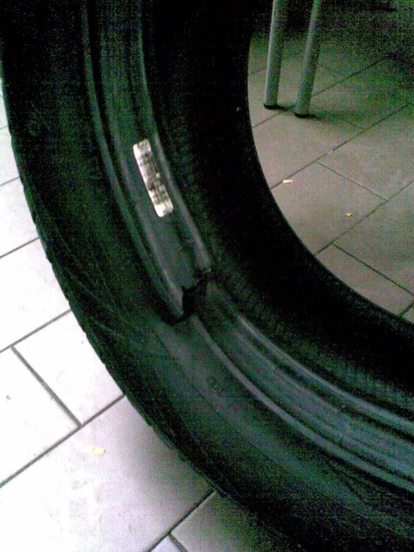

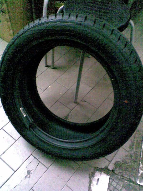

Spikedoll Clutched August 25, 2007 Share August 25, 2007 one day old dunlop D01 burst duno izi due to defect or watsoever reason but a bad experience..was very pleased with dunlop 9000 which was on my old car previously though... luckily it burst when the car was almost stationary in carpark..can't imagine if I was driving at highway or high speed..I think I would be in another suay car accident or montuary now really appreciate and thankful to Maddriver,Chonghui & Linus who came to the rescue, helped in changing the bursted tire to Linus's spare tyre... Due to most tyre workshops are closed on weekend evening, we drove to Balestier wkshop , was quoted Nanking normal tyre $100 /pc and other normal around $140+ think wanna chop me in such situation.. we then proceed to Jln Besar City Tyres Trading...Good & honest service and was quoted reasonably for Japanese tyres which are much cheaper than the former.The in charge, Bobby is very helpful and even took the initiative to pump air for Linus's spare tyre.Very pleased with his service and definitely know which workshop to go next time.They are open till 3am daily. ↡ Advertisement Link to post Share on other sites More sharing options...

Toyo 1st Gear August 25, 2007 Share August 25, 2007 what a scary experience what is the manufactured date of the tire? Link to post Share on other sites More sharing options...

Spikedoll Clutched August 25, 2007 Author Share August 25, 2007 week30 07 Link to post Share on other sites More sharing options...
Toyo 1st Gear August 25, 2007 Share August 25, 2007 very new tire leh dunlop made in japan? Link to post Share on other sites More sharing options...
Fkadir Neutral Newbie August 25, 2007 Share August 25, 2007 How old, then considered old tires and should not be bought/used? Link to post Share on other sites More sharing options...
Spikedoll Clutched August 25, 2007 Author Share August 25, 2007 made in msia only changed front 2 tyres..i never trust msia tyres again Link to post Share on other sites More sharing options...
Toyo 1st Gear August 25, 2007 Share August 25, 2007 i thk 2 years old although i heard tat the shelf life is up to 5 years Link to post Share on other sites More sharing options...
Toyo 1st Gear August 25, 2007 Share August 25, 2007 ic. ya, better dun buy m'sia tire again Link to post Share on other sites More sharing options...
DarkLord 1st Gear August 25, 2007 Share August 25, 2007 That's weird... Tire over-pumped? Link to post Share on other sites More sharing options...
Yeobh 4th Gear August 25, 2007 Share August 25, 2007 The tyre bead maybe damaged by the tyre changing machine's installation tool. Link to post Share on other sites More sharing options...
Maddriver 4th Gear August 25, 2007 Share August 25, 2007 or maybe not properly inflated during installation..should hear the pop sound.. Link to post Share on other sites More sharing options...

Joajas Neutral Newbie August 25, 2007 Share August 25, 2007 one day old dunlop D01 burst duno izi due to defect or watsoever reason but a bad experience..was very pleased with dunlop 9000 which was on my old car previously though... luckily it burst when the car was almost stationary in carpark..can't imagine if I was driving at highway or high speed..I think I would be in another suay car accident or montuary now really appreciate and thankful to Maddriver,Chonghui & Linus who came to the rescue, helped in changing the bursted tire to Linus's spare tyre... Due to most tyre workshops are closed on weekend evening, we drove to Balestier wkshop , was quoted Nanking normal tyre $100 /pc and other normal around $140+ think wanna chop me in such situation.. we then proceed to Jln Besar City Tyres Trading...Good & honest service and was quoted reasonably for Japanese tyres which are much cheaper than the former.The in charge, Bobby is very helpful and even took the initiative to pump air for Linus's spare tyre.Very pleased with his service and definitely know which workshop to go next time.They are open till 3am daily. Bro, can i make a suggestion? I guess your tyre was damaged during the process of fitting it onto the rim. Your tyre is still new from factory. your pic suggest that the tyre failed not becaused of quality issues. Most likely caused by external factors. Just my 2 cents. Link to post Share on other sites More sharing options...

Lifemoveon Clutched August 25, 2007 Share August 25, 2007 I changed into a set of the D01 1 year back in Malaysia for RM500 - including balancing/alignment etc. I think the manufacture date is about the same as yours. Served me pretty well so far. Pretty good grip in the dry and wet, definately much better than the Aspec DB in the wet. Pretty scary looking at the damaged tyre. Could it have been an overinflated tyre coupled with air expansion in the sun, resulting in the burst tyre? Though the tyre is manufactured in Malaysia, it should have been done using Dunlop's process and subjected to QC checks. Wonder what really happened. ↡ Advertisement Link to post Share on other sites More sharing options...
