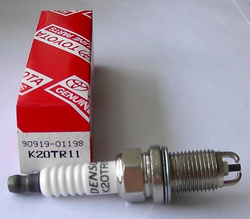

Vtim 3rd Gear April 28, 2008 Share April 28, 2008 this is the standard 2 legged copper plugs from Denso ↡ Advertisement Link to post Share on other sites More sharing options...
Garlic 1st Gear April 28, 2008 Share April 28, 2008 Are there any benefits of such a design or is it just plain marketing gimmick? Link to post Share on other sites More sharing options...

Genie47 1st Gear April 28, 2008 Share April 28, 2008 The issue is that they seem to interfere with the gas flow. Link to post Share on other sites More sharing options...

Genie47 1st Gear April 28, 2008 Share April 28, 2008 The materials are cheap since there is no platinum, iridium or gold-palladium. Electricity takes the path of least resistance. So there might be a 0.0000001mm difference that our gapping tools do not measure but the electricity going to jump the gap knows which is nearer so it goes for that one. So it keeps firing and firing and firing until that side gets worn and the gap become big and the electricity this time sees they other ground being nearer and it starts firing to that ground. It keeps doing this until it sees the other ground that it used before being nearer now so it fires to the other ....... and so forth. Advantage? Longevity for a cheaper material cost but you can boast and rip of unsuspecting customers thinking both grounds fire at the same time. Charge higher price loh! Then there is this thing about interfering with gas flow in the area. No proven studies yet though we know a lot about an expanding flame kernel for the single ground electrode. You have to go to NGK website to take a look. It is sort of one sided. The flame kernel expands outward to the area where there is no ground electrode. If you got two, it looks like a scenario where the gases cannot flow very well. Imagine if you have four. Some engines suffer on these multiground plugs while some don't. You got to try them. I suggest using the Super 4s since they are cheaper to see if it works for your engine. Link to post Share on other sites More sharing options...

Cyberet Neutral Newbie April 28, 2008 Share April 28, 2008 my veh suffers poor fc with super 4, but works extremely well with the 2leg denso coppers.. too much of a good thing may not be great after all Link to post Share on other sites More sharing options...

Genie47 1st Gear April 28, 2008 Share April 28, 2008 Then use the Denso K20TRs then. They are cheaper too, right? Link to post Share on other sites More sharing options...
