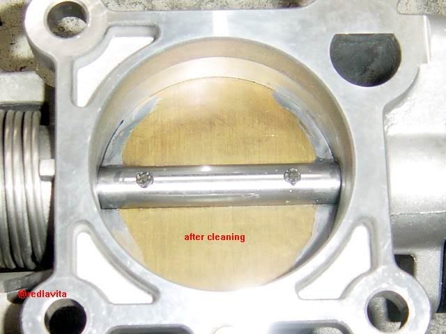

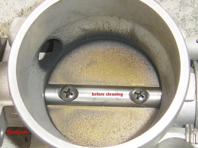

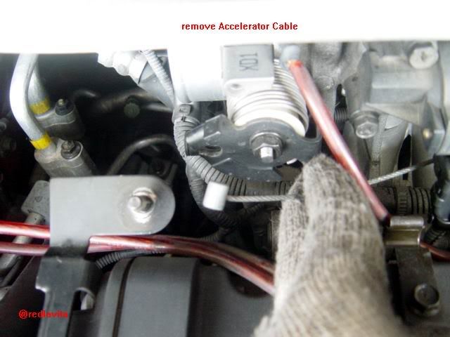

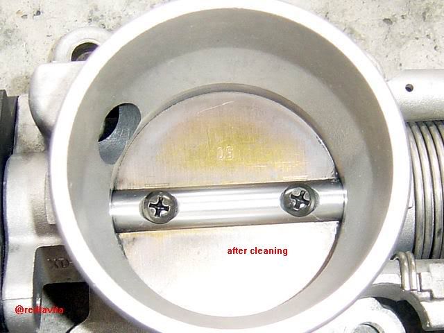

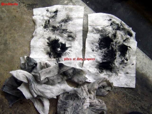

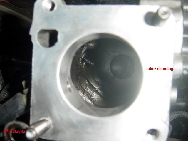

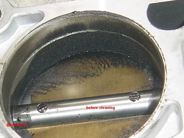

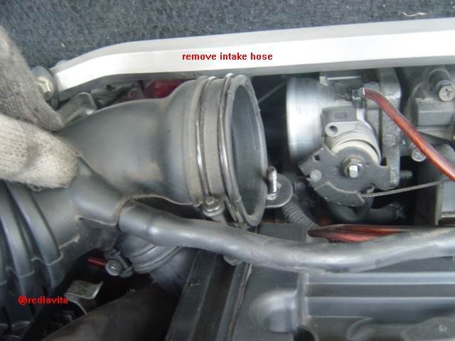

Redlavita Neutral Newbie September 8, 2009 Share September 8, 2009 i DIY my TB, below some pictures, i used wet tissue to clean away the deposit 1st, then spray with 3M contact cleaner. Clean clean after that. Also sprayed into the manifold area, as far in as i can. Link to post Share on other sites More sharing options...

Ryanyusoff 2nd Gear September 8, 2009 Share September 8, 2009 u mean after wiping with tissue,then spray the 3M contact spray on it and wipe again? Link to post Share on other sites More sharing options...
Kyojin 1st Gear September 8, 2009 Share September 8, 2009 easy job. if you don't want to remove the throttle body you can just remove the intake pipes and get to it. notes: - use good, thick paper towels or clean rags - BECAREFUL not to drop ANYTHING past the throttle plate! 1. wipe around the throttle plate first to remove deposits 2. spray generous amounts of carburetor cleaner around the throttle plate and let it soak for 5-10 min 3. clean off the black liquid and deposits 4. use a broom or brick to depress the accelerator. make sure it is FIRM AND SECURE. you don't want it to snap shut suddenly 5. with the throttle plate open, spray the carb spray down the throat and clean. you can use a toothbrush to help you scrub, it'll quickly turn black, just clean it off and spray more carb spray that's the basic stuff but i would go a step further to remove the intake manifold and EGR pipe to clear out the gunk. it's really disgusting how dirty it is in there! Link to post Share on other sites More sharing options...

Redlavita Neutral Newbie September 15, 2009 Share September 15, 2009 u mean after wiping with tissue,then spray the 3M contact spray on it and wipe again? hi, i wipe with wet tissues to remove as much dirt as possible before spraying with 3M contact spray, it will then dissolve the remaining dirt leaving your TB clean clean. Of course you can chose to spray with contact spray, but you got to use a lot of it. cheers Link to post Share on other sites More sharing options...
