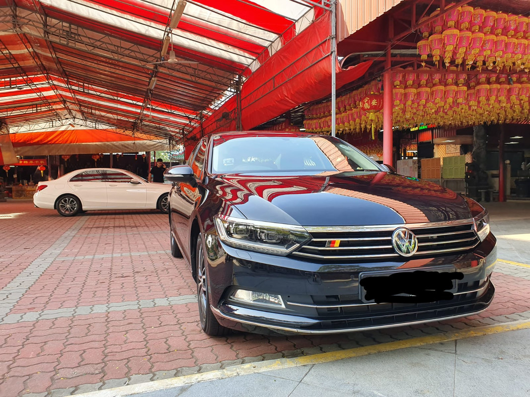

BlitzStryker 2nd Gear July 21, 2019 Share July 21, 2019 Gotten my new ride, looking to join passat chatgroup.Is there any chat group? Or Facebook group?Thank you :) 2 Link to post Share on other sites More sharing options...
Mani5417 Clutched July 23, 2019 Share July 23, 2019 (edited) Gotten my new ride, looking to join passat chatgroup. Is there any chat group? Or Facebook group? Thank you :) Congratulations, brother! Welcome to the VW family. I got my B8 about one month ago. Enjoy the drive! Mani Edited July 23, 2019 by Mani5417 Link to post Share on other sites More sharing options...
Bluemint 2nd Gear July 23, 2019 Share July 23, 2019 [pic deleted] Gotten my new ride, looking to join passat chatgroup. Is there any chat group? Or Facebook group? Thank you :) Nice. Congrats on your new ride. [Thinking out loud] I thot there's a face-lift? Link to post Share on other sites More sharing options...
