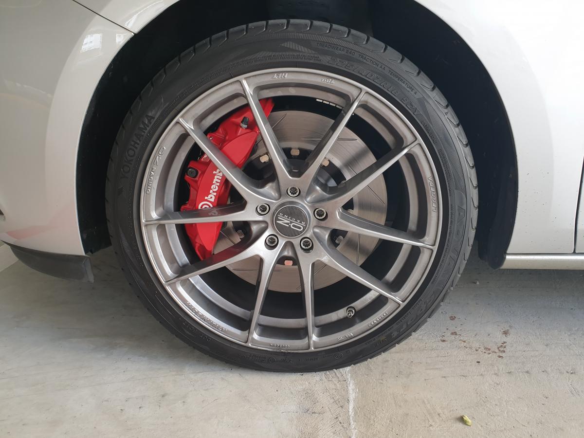

Whattheheck 2nd Gear December 28, 2018 Share December 28, 2018 For those with the weird undercarriage sound when turning and braking, I may have isolated the fault origin. It should be from the stock brake calipers. I have replaced brake pads, rotors to no avail. I went to replace my front brake system with Brembo 6 pot calipers, Brembo brake pads, rotors and brake hose and guess what, no more sound when turning and braking. Anyway for those who wants to change to BBK, I suggest you have 18in and above rims then change. Because 6 pot BBK requires some clearance space cos it is huge. I changed mine with Braking Point. Friendly chaps. Those interested can contact them directly for quotation. 2 Link to post Share on other sites More sharing options...
Chisiang 2nd Gear December 28, 2018 Share December 28, 2018 Can PM how much was the bbk? They have 4 pots? ↡ Advertisement Link to post Share on other sites More sharing options...
