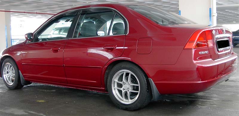

Vtim 3rd Gear January 5, 2004 Share January 5, 2004 generally, 16" rims will be slightly heavy than 15" rims & also more ex, same goes for the tyres. That doesn't means that 15" tyres are no good, it's just the 'chio' factor that the 16" will look nicer that's all (IMHO). If you go for 16", the tyres will be 205/50/16 . You can get very good & light 2nd 15" rims in SHC/CarTorque/TCS. The Enkei CPS-II are not too bad & quite light attach is the pics of the CPS-II in my previous civic I had the ST115 on the Civic for 18mths then went for PG session , come back have to change tyres liao (Kumho 712) for brake pads, you can also try Trestor Link to post Share on other sites More sharing options...
