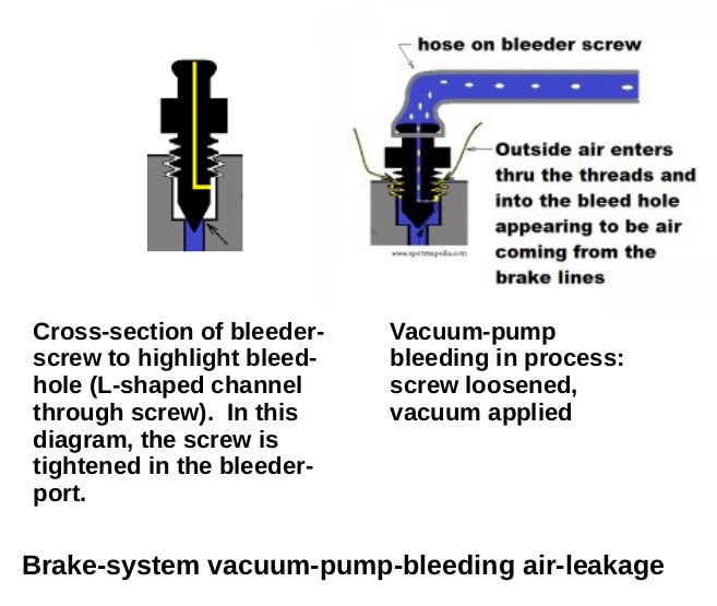

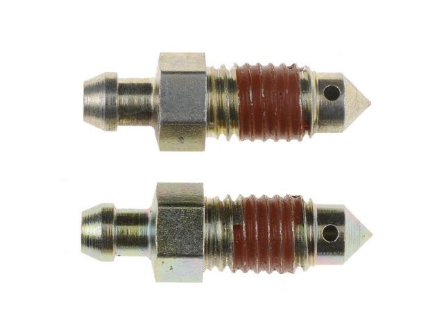

Gnahp Turbocharged July 25, 2025 Share July 25, 2025 On 7/25/2025 at 9:15 PM, Mkl22 said: Pressure. Have done both. Pressure is easier once properly setup with correct cap. same here, tried both and I prefer pressure bleeding too 👍 vacuum method will suck air through bleeder screw threads you can't tell the air bubbles in the tube is from the brake circuit or air suck through the bleeder screw threads some people avoid that by applying thread sealant or PTFE tape on the threads but after a few bleeding, those sealant/tape will wear off and air will pass through the threads again ↡ Advertisement 2 Link to post Share on other sites More sharing options...
