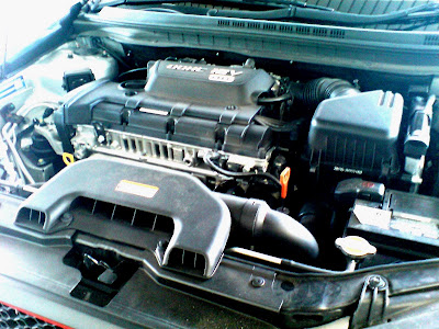

is this the stock avante engine bay??
That's a X20 engine bay.
X20 is 2L Avante in malaysia. I believe the engine bay layout is the same as the 2L in SG.
